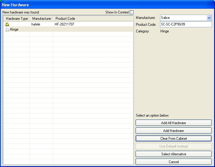

Re: Hinges not showing up
Rick,
As a side note, this is another cabinet that I am unable to open. There is one hardware item that diesn't have a hardware type listed and I cannot add the hardware or remove it from the cabinet..
