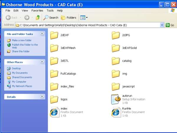

I have a Osbourne Wood products CD and would like to add the proper files into Ecabs. Which ones do I have to copy and where should I put them. Should I just take the STL files and put them in Display Objects or what else do I have to do??

You will have to open the .stl files in the display part editor and make any changes you want and then save them from there. They can then be used as display objects.
I have converted most of them and you can download them HERE
Unzip the files and then copy or cut the folder into your eCabinets import folder. You can then access them as display objects.
I have also done many of the Hardware Resources items and they can be found HERE
