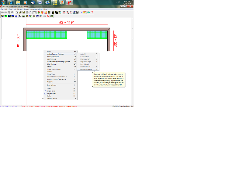

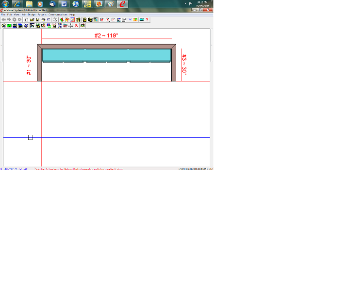

You could use the Equalize feature in Custom Layout. Create an alcove, place desired amount of cabinets. hilte the cabs click Equalize. You now have equally spaced doors.
119 wall.png (102.33 KiB) Viewed 5571 times
119 wall 2.png (60.84 KiB) Viewed 5571 times
