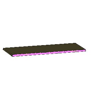

When I try to change the depth on this part, I get an error message and the part edits disappear. Does anyone have any ideas on how to do the constraints differently or is it a glitch? I want the holes to be 37mm from the front and back and be able to change the depth.

The attached file should work for you. I've substituted RTA fittings for your Part Editor cuts. You can control their placement through Construction Settings > Top Construction Parameters > KD/RTA Placement. I can post the Hole Editor file I used for the fittings, if needed.

I didn't think about doing that Nat, I guess it just didn't occur to me since I had deleted all the other parts to the cabinet. Thanks a bunch!
But... on other cabinets I have this issue where I have dowels as the KD fitting and I want to use Rafix also. When I change the depth the part edits for the rafix disappear.
