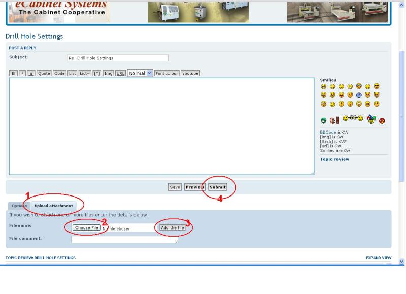

1. You need to use the "upload attachment" tab below.
2. click the "choose file" button and find the cabinet
3. "add file" button
4. submit
-John

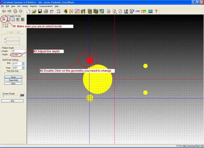

Just pull up the default pattern and double click both holes to highlight red. Then enter your desired depth and hit enter. Save as new name or under existing and your good to go. Make sure you change on all existing cabinets by highlight doors and applying to selected parts.

Thanks Forest for chiming in! As I was going through the process the way you described occurred to me.
Rob, here is a jpg of the steps.
-John
