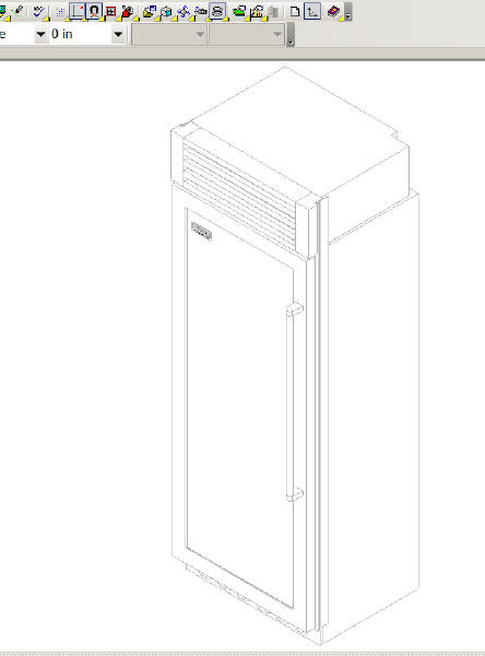

Here is how it opens up in just 2 of my Cad programs
1-TurboCAD Professional
2-Punch! ViaCAD
I would say you need to change something in your Accutran then it will open ok
2-Punch! ViaCAD
