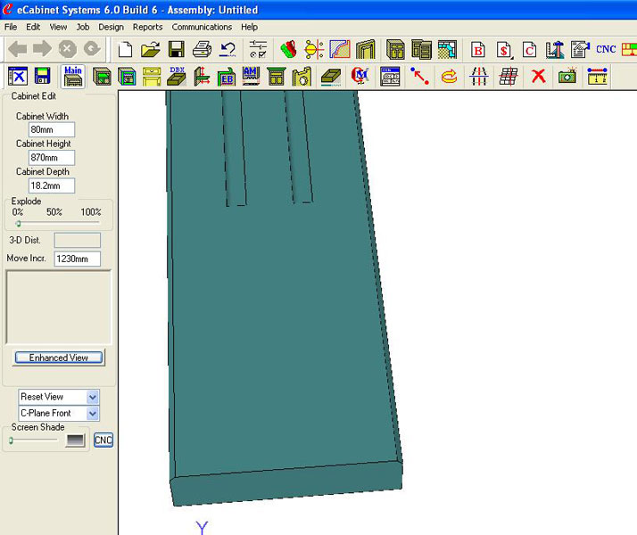

Is it possible to make this in control nesting not the profile modeller, there are 2 outer bevels and 2 inner flutes on the part in the picture
Thanks Stephen
2 outer bevels 2 inner flutes

If created in the part editor correctly, it should work fine.

We are very disappointed to here Control nesting will only recognize 2 of the 4 regions, Daniel when will we be able to work with multiple regions in the nest!
Cheers Stephen

So you are saying Control nesting will recognize all 4 regions and machine properly, If its created in the part editor correctly!
Thanks Stephen

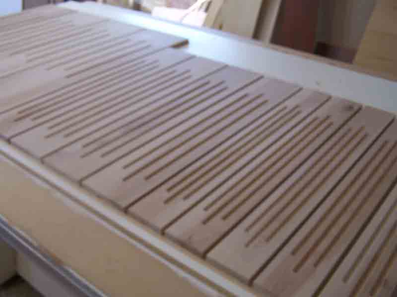

Stephen,
I make my fluted panels as a cabinet back with 1/4" partitions. I replace my 1/4" endmill bit with a 1/2" round nose bit. I don't do a chamfer on the edges but you should be able to use a 45 degree chamfer bit as a custom tool. Another option would be to do the chamfer as a rabbet and switch another tool(1/8"endmill?) for yours chamfer bit. Hope this helps. Sometimes you have to lie a little and think outside the box. :idea:
Brian
4 by 35 Flutes w chamfer.jpg (5.35 KiB) Viewed 17855 times
4 by 35 Flutes w chamfer.hsf
(256.02 KiB) Downloaded 1257 times

I apologize. There was some confusion with my first post so I corrected it. Control nesting will see multiple regions but only has the ability to use a custom tool on the first 2 regions. Again, I'm sorry for the earlier confusion.

Necessity is the mother of all out the box thinking! so we have used Panelmetrix to solve this one :beer:
