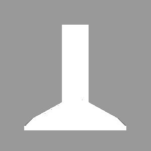

Post by Scott G Vaal »
Here is that same range hood as a display object with a more uniform texture (removed the tiled look). You can re-load this into the Display Part Editor and re-texture it to your liking as well.
ss_range_hood-1.hsf
(40.02 KiB) Downloaded 751 times

Hi Scott
I save it off the forum to downloads but its saving as an ESA file not an HSF file.
So if I go to display part editor and go to load it from there it doesn't show up on the list as it needs to be 'files of type STL/HSF' clicked on the drop down but no other file options.
If I try to load it directly from downloads using ecabs the homepage opens with a pop up that says invalid file.
The one that you altered I can save no problems as its an HSF
Would appreciate your input !
Scott G Vaal
Re: downloading 3D files
Al,
This particular item was saved as an assembly made up of display cubes. Since its an assembly {.esa}, it cannot be loaded into the display part editor or saved in the import area and loaded like a display object. It can only be loaded into the cab/assm editor or loaded into the custom layout as an assembly. I did an export selection of this assembly to get it saved off as an {.hsf}, then I was able to load it into the display part editor to texture it and save it off as a new display object. Hope this explains it well enough.
