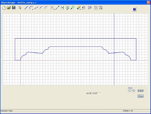

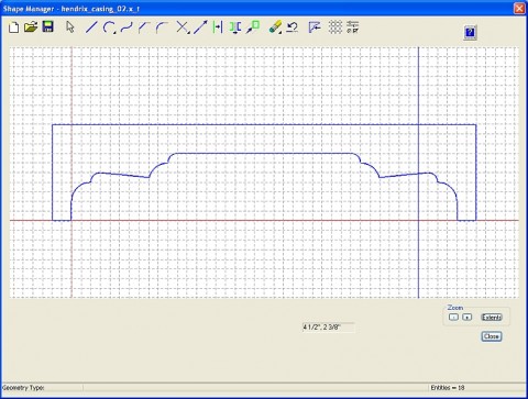

Thanks for your response but I modified my tool from this
to this
and it now works on the cut out part. I can verify tool pathsin the Profile Modeler.

Ryan Hochgesang
Re: Problems Profiling
It looks to me that extending each end of your tool downward has allowed a better clean up as the part is created in Part editor.
