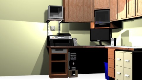

Is it possible to place a light switch on the cabinet instead of on the wall?
Re: Light switch
Hi Ruben, it is possible by using a Display Object. I don't have one, but I have a DXF file of a double plate if someone can convert it.
lightSwitch- Double.zip
(3.36 KiB) Downloaded 647 times
Re: Light switch
Light switchs with Plate
ws 2-plate.hsf
(116.02 KiB) Downloaded 624 times
Re: Light switch
Your the man George!
Re: Light switch
Thank You Rick
I hope it works for Ruben
