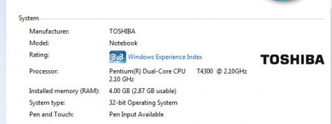

I have not used ecabs for a while as I have moved countries but want to resume using it and have some designs in need of sorting so would love to get it running smoothly. Its on a Toshiba Sattelite P300 PSPC4A running Vista 34 bit with an ATI Mobility Radeon HD3650. I have run the update as a repair and it made no difference.

Thanks everyone, I will give it a go. It seems that my graphics card is not the best , also I have learnt that ATI had some agreement with the laptop manufacturers that make it hard to actually update the driver, also the hardware acceleration option is turned off. Here is a link to one of my options that I tried but with no success, when I check my driver afterwards its still the old 2008 one, ahhh!
