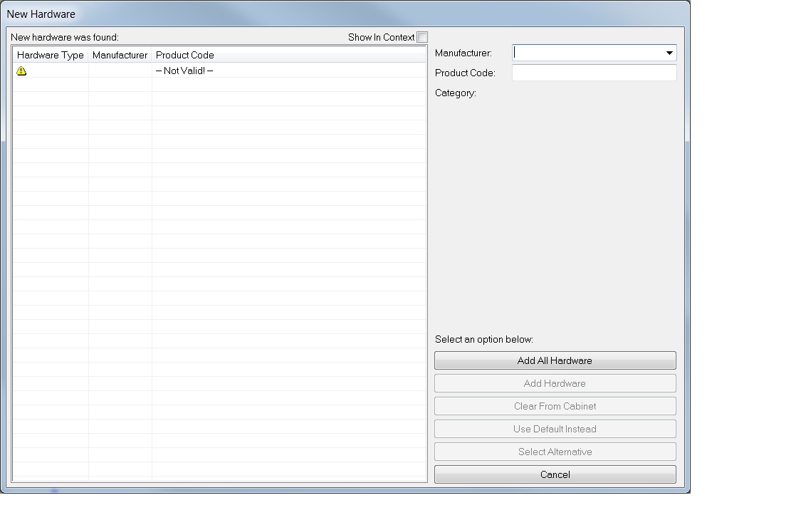

Everytime I open a cabinet I seem to get this dialog. I click on the button 'Add All Hardware' each time, but when I go to save the cabinet, for some reason, a setting is not getting set saying I added all the hardware. What are the steps I need to do to keep this from coming up each time?

Is it any cabinet or a certain cabinet? Can you post the cabinet? Can you also zip up and post you localstore.mdb? (C:\ProgramData\Thermwood\eCabinet Systems\localstore\LocalStore.mdb)

Rick - I don't have a \localstore subdirectory under C:\ProgramData\Thermwood\eCabinet Systems.
The problem seems to be any of the cabinets I've made that are part of my product line of RTA cabinets that I'm putting together. I attached 1 of the many cabinets in this product line. They all seem to do the same thing in bringing up that Add New Hardware dialog box.

If you didnt have the localstore.mdb, none of your hardware would work. The cabinet does have a problem with it. It thinks that it has a Accuride Drawer Box Slide set on it, but does not have all the info for the slide. It has accuride as the vendor, but no model/product-code set. I will have to look more into when I get into work.
