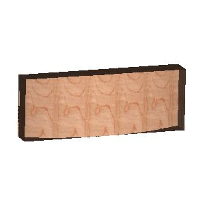

But I tried that and the Attached pix and hsf file is what I get.I guess what I am asking Is would it be possible to have a selection for no edge banding just as in the edge banding editor
test door.esa
(118.02 KiB) Downloaded 492 times
test door.jpg (7.43 KiB) Viewed 8254 times
Rick Deskins
Posts: 858
Company Name: Thermwood
Re: Door desighner question
Post by Rick Deskins »
For a case like this, you should use a display panel. Then use the user part name feature to label the display panel as a door.

Thanks Rick that is what I will have to do but this method will not allow me to have the door actually on the cabinet without making it an assembly. I was hoping to avoid that by using a display door instead as all of the doors and drawer fronts for this job are made like the one I posted. Also any hardware holes will have to be placed manually .I could live with the visual deal but that does not look good for a presentation. Also how would the machine react?Maby the option to remove edg banding from display doors could be added?

Sorry guys I posted the last before actually giving it a try the display panel method will work without saving as an assembly but I will still have to apply any hardware holes manually
