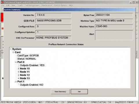

Hello DanielDaniel Vonderheide wrote:I was able to reproduce the issue now that I have seen the code you produced. When we tested the issue here, we were testing on version 7 and higher THM software. After seeing your code, I wrote the code for version 6 THM software and was able to reproduce the error. I have informed our software engineers of the issue and am expecting a response back from them.
iam glad to hear that you are able to reproduce the issue but the version you are talking about dosent seems to match with ours.
we are having current version as THM 7.x.x.x
also please find the attached screenshot and the text file of the machine (just thought it could be handy for digging up the info)
Mohan
