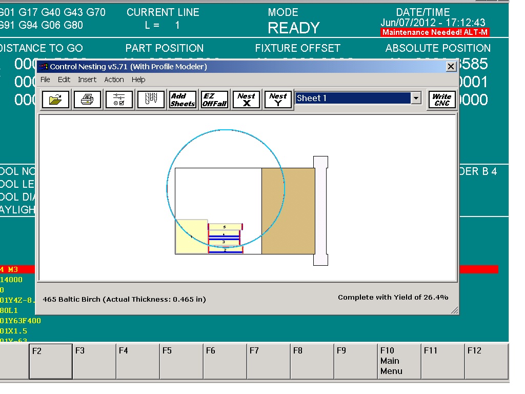

Anyone having a problem in CN with the fronts of pull-out type drawers? (Pantry) We put a 3 point arch in the top of the front panel for a finger pull kind-a-look never had a problem, now CN shows a full circle... of course it goes off the table so were getting an X axis out of bounds?

Here is what I get after Nesting.

Well, I tested your file going out to control nesting and all worked for me. So, there must be a setting on your control nesting that would produce this. I will need to get the export from your control nesting. Go to control nesting and load the twd you are having problem with. the go to file->Export and save off the export file. It will be a *.cab file. Then post that and hopefully we can find the root of your problem.
