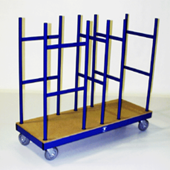

Here ya go Thom, I found this
http://www.shopcartsusa.com/pc.htm

I use these, they work really well with 4 castors on the bottom.

The ShopCarts that Glenn shows are the ones that I bought. After all of the cutting is done, I restack horizontally on a flat cart. This take up much less space.
