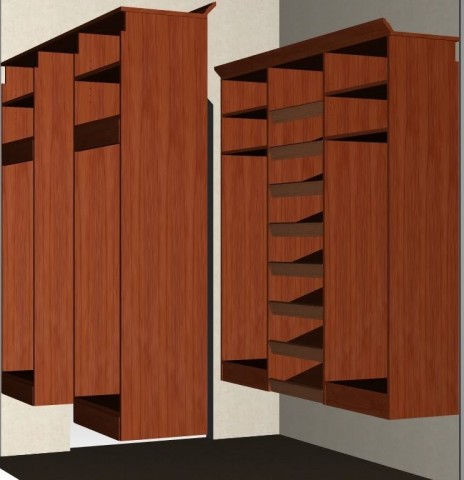

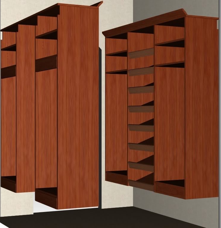

You're probably looking for something like this--Nat Wheatley wrote:Is there any way to do an angled/sloped shelf?
I can't open the file now as it was done in an early version but I didn't move any holes -- I just used the next higher back hole and notched the front underside of the shelf so it wouldn't slide off the shelf support.

Thanks Wally, I just saw this reply. This particular cabinet is just a single shelf, not top/bottom but I do like what you've shown for those shoe towers and will give that a try next one we have.
