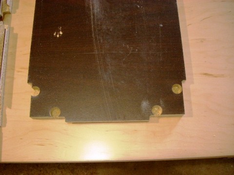

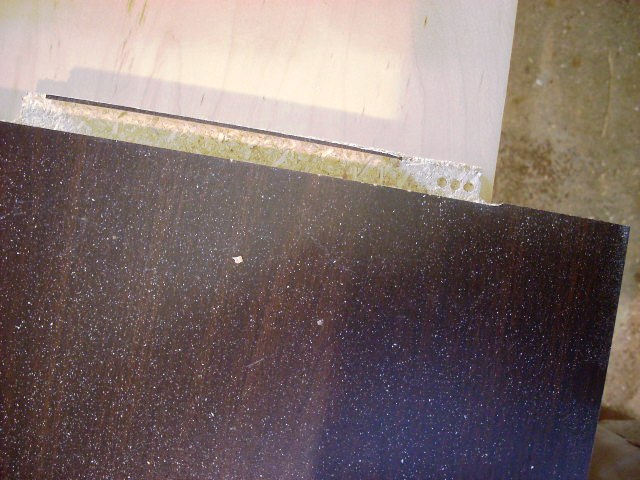

We successfully were cutting flip operations a couple days ago. Then have been running a series of jobs without flip ops. Now back to flip op job and the X axis is off and flip ops are coming out wrong. See pictures. Y axis appears to be correct. You can see the dado is too long on one side leaving an extra piece on flip side and they are too short on other side. Or you can see the KD holes don't line up and are whole circles on one side and too short on the other. Off by about .125 (guess, not measured).
We did have an X axis C-marker error in recent days and would that require us to have to reset all the G52 fixture offsets?? This is the only thing we can come up with that would explain this.
And to clarify, when we do flip op on back side, we use G52 marker for the corner of the fixture, bottom left of the sheet. When we identify the sheet G52, we should be using the same G52 correct??? We are a YouBUild location and when our machine was re-configured for YouBuild, Jody created the flip G52 as #1 and the sheet G52 as #2. Why would they be different??
We maybe overlooking the obvious here but we are absolutely stuck.
Can you help?
[attachment=0]Flip 1.jpg[/attachment
Can you help?

Go in there and make the necessary .125 adjustment to the axis G52 location and give it a try .

I know we can make the adjustment but actually have 2 questions:
1) Don't we actually have to make 1/2 of the .125 adjustment?? Just checking my thinking.
2) Is this something we will have to do every time we redo the C-marker? Is that what caused this? If not, then what did we do?
3) should my flip fence offset be the same for back and front side of the sheet? Thermwood set us up for 2 different G52s and I am thinking they should be the same? If you do flips Wil, could you check your settings for fences and tell me if your flip and sheet fence offsets are the same G52?

Wil, thanks a ton. New day, new perspective. My plan is to verify my fixture offset by locating a sheet and then going to G52L1 and see if I am correct. Then I am going to (I think) find that X axis is out by 1/2 of 1/8" probably from the C marker reset we had to do. Correct my offset in control, cut a set of 3 pieces using a scrap sheet and verify. If my G52 is correct, which I can't imagine, then I am going to fake it.

Wil, I checked G52L this morning and all are dead on within 0.004. Outline tool is correct and diameter verified. got it all ready and should be good. Ran one part and BAD!! This is going to drive me to swearing and drinking. Have made contact at TW but they are not yet in. I will post the resolution when I discover it, even if it is something stupid I have done, which is highly likely.

Problem resolved. Issue was ours, not Thermwood! Ever feel like choking your help??? Here is what I sent to Joe at Thermwood outlining the solution. One big lesson is to re-verify the G52 locations if you ever get a C marker error and have to reset the axis. I am convinced that is the start of this but it went on so long for our own stupidity!
I think problem is resolved. I write this with a lot of egg on face.(!) Based on the insistence that programs are correct, etc and had to be in the G52L1, last night I took my operator and physically watched him verify the coordinates of fixture offset. Turns out we found 3 things:
- Biggest problem was the operator was verifying the G52 location using a 3/8 tool and when doing the math was subtracting the tool radius of 0.249 creating the vast majority of the error.
- There was a small ding in actual fixture where it got dropped or something and while only a few thousandths, not helping.
- The C-marker error we had must require that we "re-verify" or recalibrate the G52 location. Supposedly we had done it multiple times but operator using wrong tool dimensions oddly matched the error we were seeing within reason. Any time we have a C-Marker error we are going to verify G52 presets in future.
We had to make a new G52 location and successfully made good parts.!@#$%^&*
Sorry for any hell we put you through for our own stupidity! But most of all thanks for hanging in there with us. Watch your mail for a thank you.
