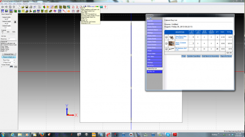

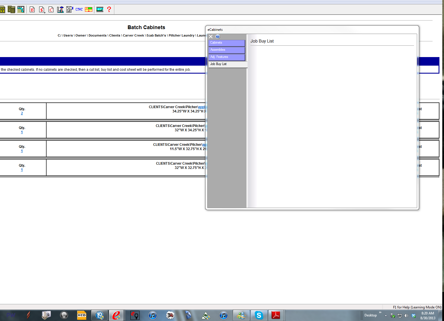

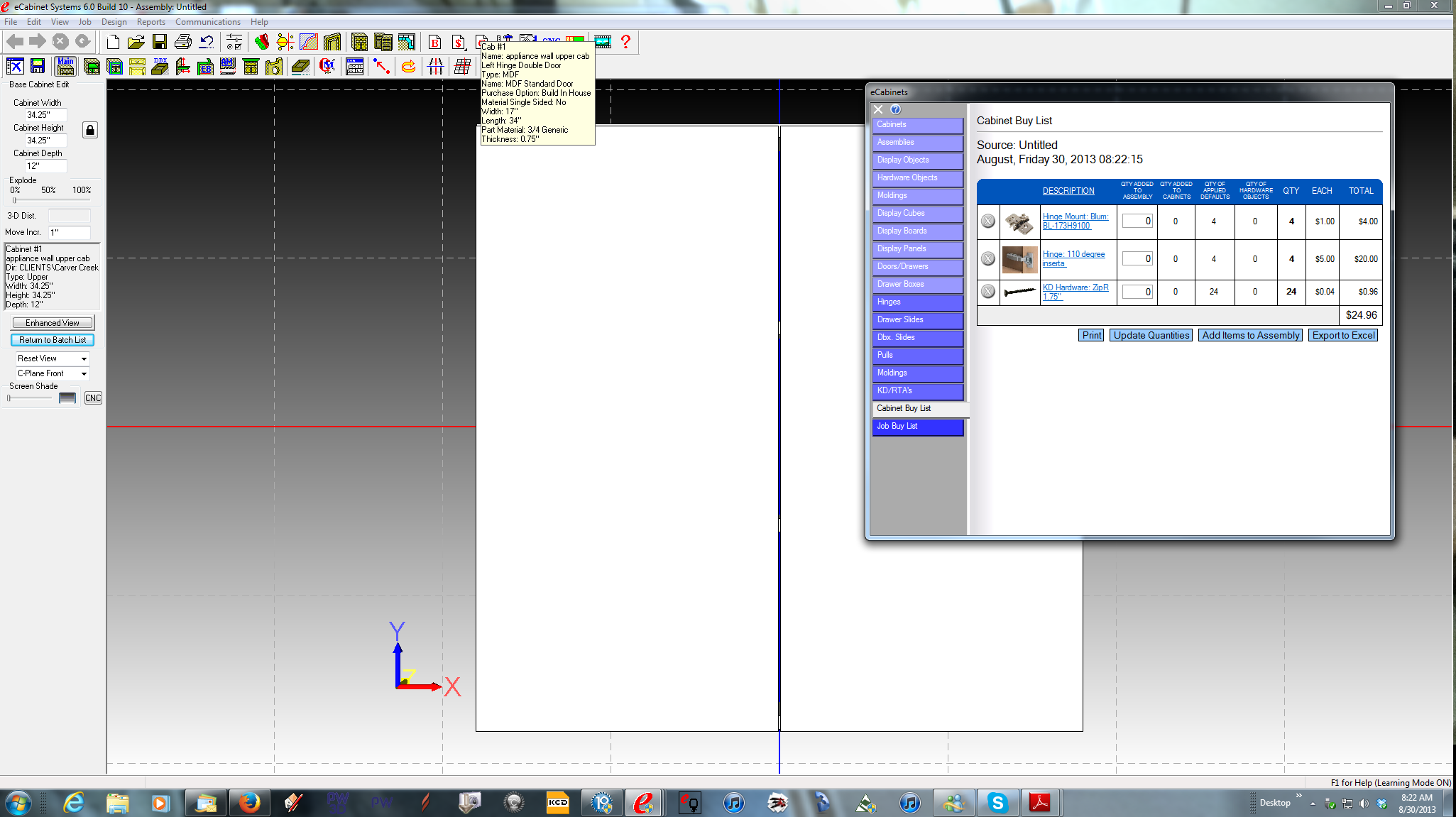

Now that I've got pretty pictures to accompany my go to hardware list I would like to be able to print these lists from a customers job. This is attractive for the other small shops I'm cutting for.
When I hit the 'Jobs Buy List' selection in the window menu it's a dead button, though the instruction say it is supposed to work. Attached images are what I'm getting from the jobs buy list and cabinet buy list showing the dead button compared to cabinet buy list.
Is there another dirt road to take to get a list similar to the one in the 'cabinets buy list' for the 'jobs buy list' that will have the pretty pictures and easy to read layout, as opposed to the old standard harder to read print out from the 'BUY LIST' icon in the main tool bar.
No big deal if you cant get there from here and have to use the old print outs. Was just hoping that time spent on updating pretty hardware pictures was going to help me make nicer looking jobs buy list.

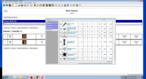

I use it all the time but it works as expected. Post the job you are working on.
Re: Updating product image
That's frustratingly good news. Two other people can get it to work so must be something on my end. Here's an attached batch that was not working with the 'Job buy list'. Kerry, if you can get it to work I'm wondering if I need a repair of my current Ecabs build?
