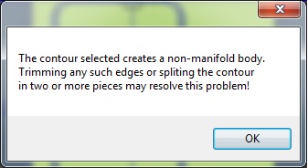

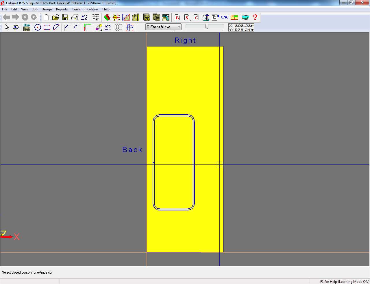

In part editor, I am able to create a cutout for a circle 5mm to 25mm and so forth but when I try to make a sink cut out it comes up with an error as attached picture will show. I didn’t have this problem before the versions build v6 ver 12 but as soon as I updated to 12 and 13 the ability to do so had gone. I have tried re-doing it I have restarted ecabinets multiple times, restarted computer and also tried on many other materials and everything with this design doesn’t work anymore.

Looks like there is a line connecting the two outline shapes, try deleting it, pocket through the center shape and use profile modeler to create the rebated lip if that's what you're trying to do.

I have reproduced the issue here and will get it listed and fixed. As a work around for now, you can widen the gap between the 2 lines so that you have a little over .1" (2.54mm) and it should perform the cut. I used .105" (2.67mm) and it worked for me. Sorry for the inconvenience.

Thanks Scott . The suggestion worked a treat so all smiles here. :wink:
