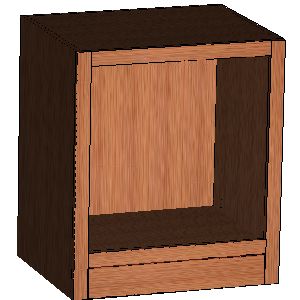

Hi Don,
I'm not a guru but if I remove the deck and place a mid rail 4.5" off the floor I can install a drawer in the opening
hope this helps :D
Tim

Hi Donald.
You can achieve this by removing the deck as Tim stated. Then install a fixed shelf at the height that you wish. Then you can install a drawer with a front inset that is the same as your stiles. Now you can install a slab drawer front that is of the same material as the stiles. Set the drawer front inset to the same as the front inset as the drawer box.
Hope this helps.

Start with a wall cabinet, remove the deck, and apply the face frames as desired. You can put a drawer anywhere you want.
