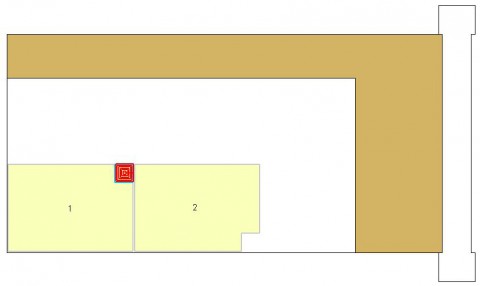

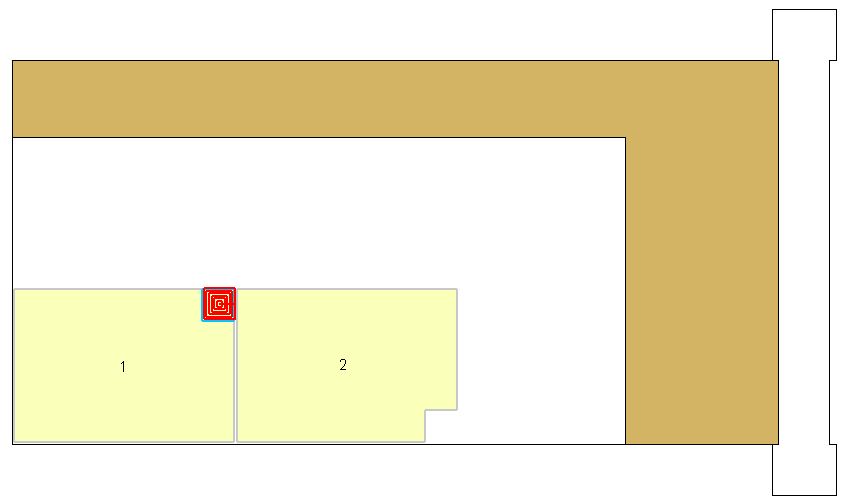

The only way I could think to get it to do what you want is if in CV you can do the side without a toe kick notch. Then cut the notch with a pocket, but you have to leave some skin behind, usually around .005" will work. The skin is needed because if it is a through cut, it will become part of the outline. If there is skin left, it will be treated as a pocket and obey the pocketing settings. Once again, not sure if you are able to in CV, but a picture is attached below of how it's done in eCabinets. The attached nest picture, depicts the difference between the left end that wasn't modified and the right end that was.

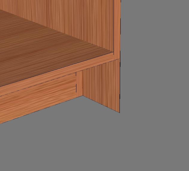

I was able to place a 5mm drill operation right there in the corner and then save that back into the catalog in Cabinet Vision. Got me the result that I wanted.
