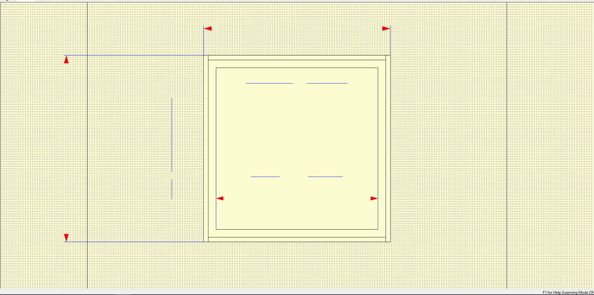

this just started happening after the microsoft anniversary update. the line drawing editor will not show measurements. i have attached a jpg of it. i tried to adjust the grid settings, turned it off and on with the same result. any ideas? thanks for you help

Have you tried updating your video card driver from the manufacturer's website?

yes I have updated the video card and it remains the same.

I am having the same issue.
If you right click and click "reset view" the dimensions will show up.
It is annoying. It seems like the cabinet is coming into the line drawing editor crooked or something and it is throwing of the dimensioning.
I think maybe the cabinets are coming in with the wrong perspective/orthographic view setting

resetting the view does correct the problem. thanks for the tip.
