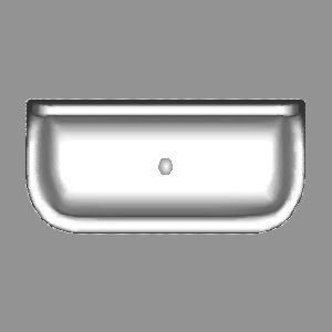

Hi Leo
See if this one works
kohler bowl.jpg (6.06 KiB) Viewed 11392 times
kohler bowl.hsf
(238.02 KiB) Downloaded 1121 times

Tried a few different ways. Kept coming up with an error.

Get Accutrans 3D to convert your files.

Got a good image off that program. Thanks.
