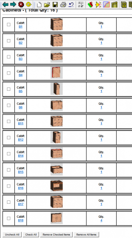

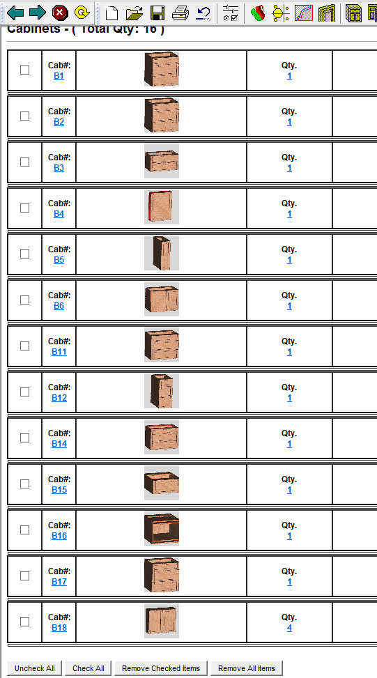

With a follow up to my post. Here is an example of a batch after clicking CNC. Note the listing on the left, b1,b2,b3......etc. See how it deletes and skips at b6.
:wall: :wall: :wall: :wall:

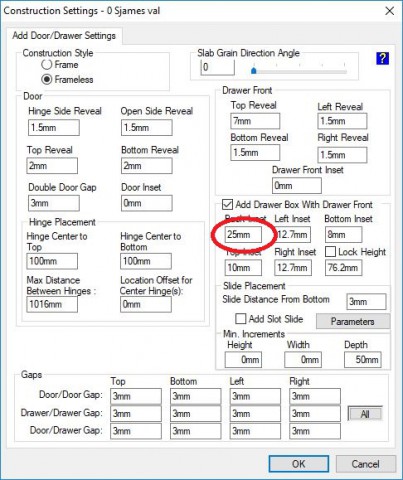

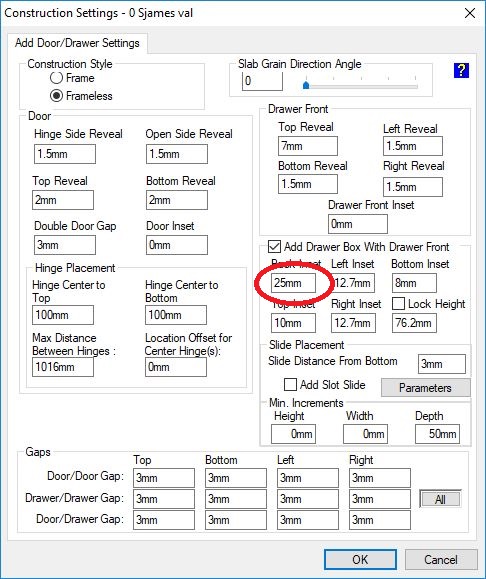

David, not sure if you are putting this out as a question or a statement... Ecabinets will automatically jump down to a shorter increment if the back thickness interferes with the drawer box length. It gets this from drawer back inset see attached.
I try to give at least 3mm extra so I don't have this issue.

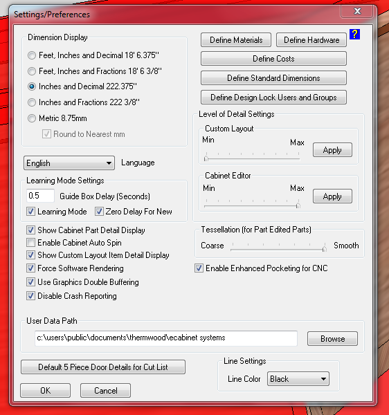

Just an update for anyone following, this morning Clint gained access to my desktop remotely after I had the the same issue with dbx resizing when editing my cabinet depth. I have attached a snap shot of the settings he changed. I believe it was "force software rendering" and "use graphics double buffering" he checked. I don't have the problem with resizing now. Just need to upgrade my graphics card as movement on the screen is choppy. I will let everyone know if I experience cabinet deleting after CNC ing.
:beer: Clint

Ian is correct in the two settings changes we made. When Force Software Rendering is checked, the software avoids hardware acceleration and the CPU renders rather than the graphics card. The Use Graphics Double Buffering lowers the frame rate.
If you are having an issue that something isn't appearing to be correct graphically or something not being displayed, we will typically tell you to check these two boxes, restart eCabinets and see if the issue persists. If it doesn't, either your driver needs to be updated for your graphics card, or the card is possibly failing.
As a follow up to Dave Egnoski's issue with drawer boxes, it is as David Giesbrecht mentioned. The cabinet was 24" in depth. With a 21" drawer box, it left 3" worth of room behind the box. The box was set with a 2" back inset leaving 1" of usable room. The back's thickness is .75" with a .25" inset so it left no room. Decreasing material thickness would have been OK, but when it was written to CNC the material thickness was increased. The box was set to go in 3" increments, so when the back material's thickness was increased, all insets had to obey. That made the box drop 3" in size to accommodate the thicker back. A smaller back inset for the drawer box would alleviate this issue as long as you don't go so small that you could jump to the next size box larger when the material thickness is dropped. An unfortunate perfect storm of numbers matching up.
