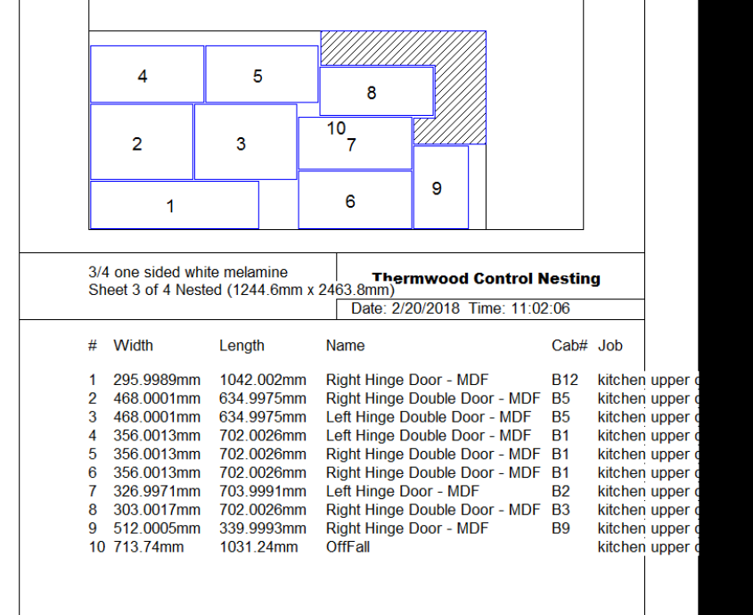

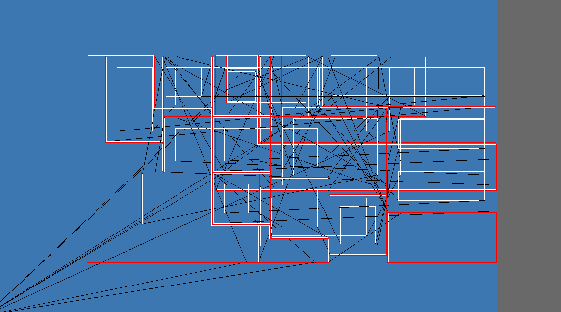

I was cutting some single pass mdf doors today and I had a 2 random doos get cut as a blanks with no profiling done to them... has anyone else had this happen? I'm attaching the picture of the nest along with the graph view showing it not getting a profile. also attaching the actual cnc code. I can give the ecabinets file and twd if needed
its part 4 keep in mind that the file is rotated 180 degrees
