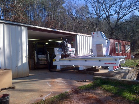

Aaaaand for fun, here is our CS-45 5x12 machine on our dock just after we got it pulled out of the semi trailer. As you can see, our shop has a low ceiling. We have to remove the controller from the table to get it thru the door. See the Bobcat inside the shop, that was used to pull it off the trailer, and eventually into the shop. Once there, we were able to maneuver it into position with 2 pallet jacks. Just take it slow and easy, and pre-plan each movement, and it will go fine. Leverage and balance are your friends...

Looking forward to some install photos like Jeremys Bobcat. He is only showing that ,now its out of warranty.

Hi Jeremy
I like your slice of heaven,
Every factory should have a pleasant outlook.

Thanks Mark, it's peaceful. I wouldn't trade it for anything - except something more peacefulMark McCallum wrote:Hi Jeremy
Very perceptive, Neville!Looking forward to some install photos like Jeremys Bobcat. He is only showing that ,now its out of warranty.
Regards Neville
Unfortunately I don't have a picture of it immediately after the delivery truck left - but the center leg was right at the edge of the loading dock, propped up on that 4x6 like it is in this picture. So almost half the machine was hanging off the dock (it's almost 16' long). Since we were controlling the balance point, it was totally under control. But it LOOKED scary!
