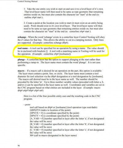

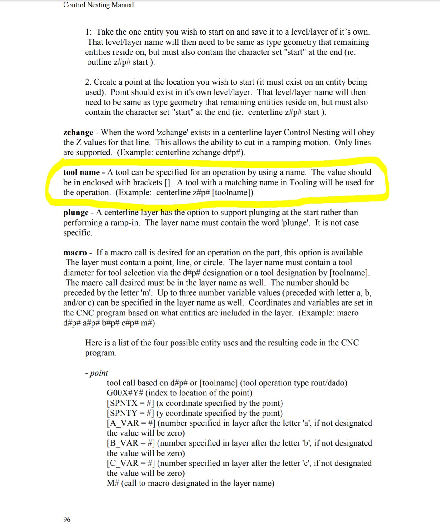

I'd start by specifying a tool / tool diameter. Since Thermwood introduced the ability to call a tool by name instead of diameter, that's how we've done it.
For instance:
the old way: pocket d9p5 z8p0
the new way: pocket z8p0 [3185]
Either way, a tool is specified. Your code isn't specifying one, so I'd try that first.

Jacob Janzen
Posts: 17
Joined: Mon, Jul 30 2018, 9:37AM
Company Name: California Closets
Re: backpocket not cutting
Post by Jacob Janzen »
Jeremy Schiffer wrote:I'd start by specifying a tool / tool diameter. Since Thermwood introduced the ability to call a tool by name instead of diameter, that's how we've done it.
For instance:
I've never specified anything other than pocket zXXpX, drill zXXpX, etc.
What is the nomenclature you're referring to? I don't see anything about it in the dxf reference.
Thanks!
Jeremy Schiffer
Posts: 1154
Location: Carnesville, GA
Post by Jeremy Schiffer »
Page 96 of the Control Nesting manual has that info.
