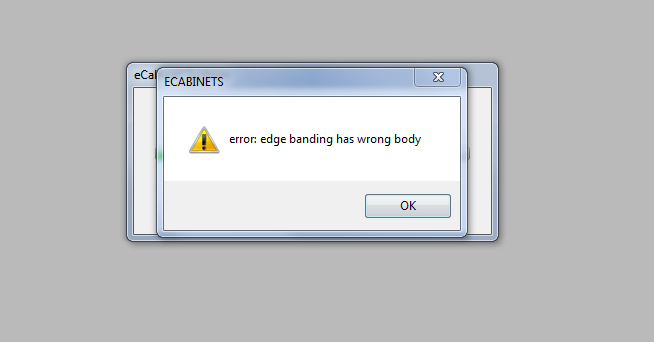

Hi everyone, this is a first for me. I have attached a pic.
I have a batch of cabinets, when I click on nest diagrams I get this message pop up multiple times. I just keep clicking OK!
I tried searching the forum...nothing
Any ideas?

Ian,
Can you post the cabinet (or job of cabinets), and if they were made from seed cabinets, those cabinets? If it is too large to post, you can upload here https://info.thermwood.com/thermwood-file-upload-page, just make sure to reference this thread.
There is a mismatch between parts and edge banding data that some customers have discovered. Its becoming difficult to pinpoint, so this is a new error message added to 6.2.9 to help detect it.

Thanks Clint, next time it pops up I will upload
