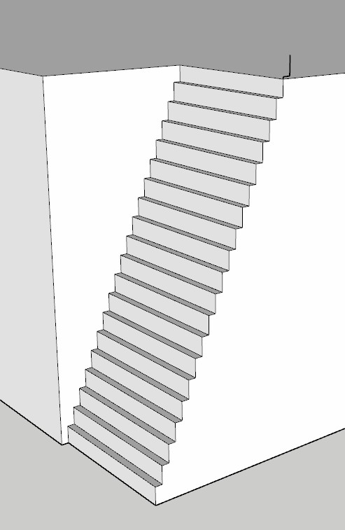

Can you provide a little detail? It seems that the surface of the bevel gets stepped, if I understand correctly. Here is an image of a cut in 3/4" material, the steps about 1/16 h. x 1/64" stepover.

Here is a picture of some 1/2" Baltic Birch Drawer parts for a Blum corner cabinet we cut this morning.
The step was .03125"
Be sure to use a down-cut bit. An upcut or compression leaves a fuzz that must be sanded.
The "Steps" in the cut make a good glue joint.

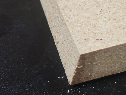

Here is a picture of a 22.5-degree bevel with 3/4" particle board for a corner cabinet back. Same tool, same nest.

One last picture. This is a 45 degree bevel on 3/4 plywood. This lets you see the size of the "Steps" a little better.
There is a little fuzzing on the plys that are cross grain, but sands off easily with a block.

What is the depth-of-step for the 22.5 degree bevel shown?

I have the step-over in the Profile Modeler for this tool at .03125 so it will step over and down that amount for every pass. That should be approx. 24 passes for a 3/4" board.
This does take a little machine time but is offset by the fact you don't have to set up special tooling for each angle of bevel or have someone set up a table saw and make the cuts after the fact.
Yes, this one tool and setting will cut all bevels of any angle nested in the same job.
