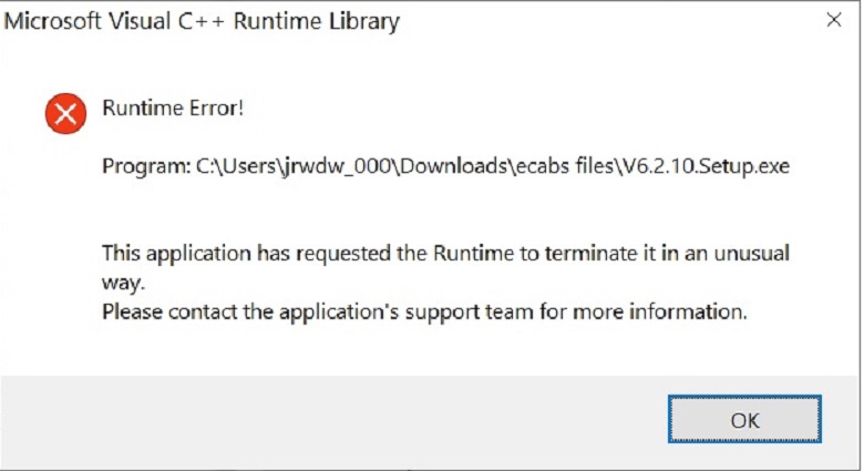

error with new update
I've never had this happen with other updates, any info would be helpful. Thanks

Try redownloading the installer, in the event the download was corrupted. Also make sure to right click and Run as Administrator on the downloaded file just to make sure it isn't permission related.JR Allen wrote:I've never had this happen with other updates, any info would be helpful. Thanks
As far as we can see and others have reported the update is good and live. Make sure when you go to the update page to refresh it in the event your browser is storing the old page in cache. If you are using Chrome you can press CTRL+F5 to force a refresh.Stuart Douglas wrote:Also, The update page on the thermwood site is still showing the old date and the download file is the old file as well? Not sure where even to get the new update otherwise.

Got it to install from the site, thanks for the help

That was the solution! Thanks!Clint Buechlein wrote:As far as we can see and others have reported the update is good and live. Make sure when you go to the update page to refresh it in the event your browser is storing the old page in cache. If you are using Chrome you can press CTRL+F5 to force a refresh.Stuart Douglas wrote:Also, The update page on the thermwood site is still showing the old date and the download file is the old file as well? Not sure where even to get the new update otherwise.
