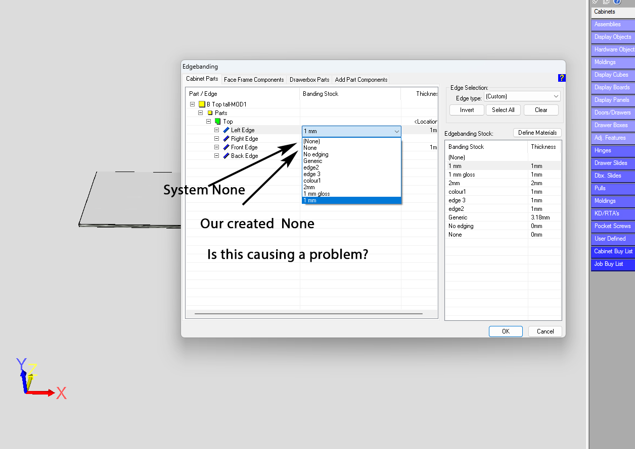

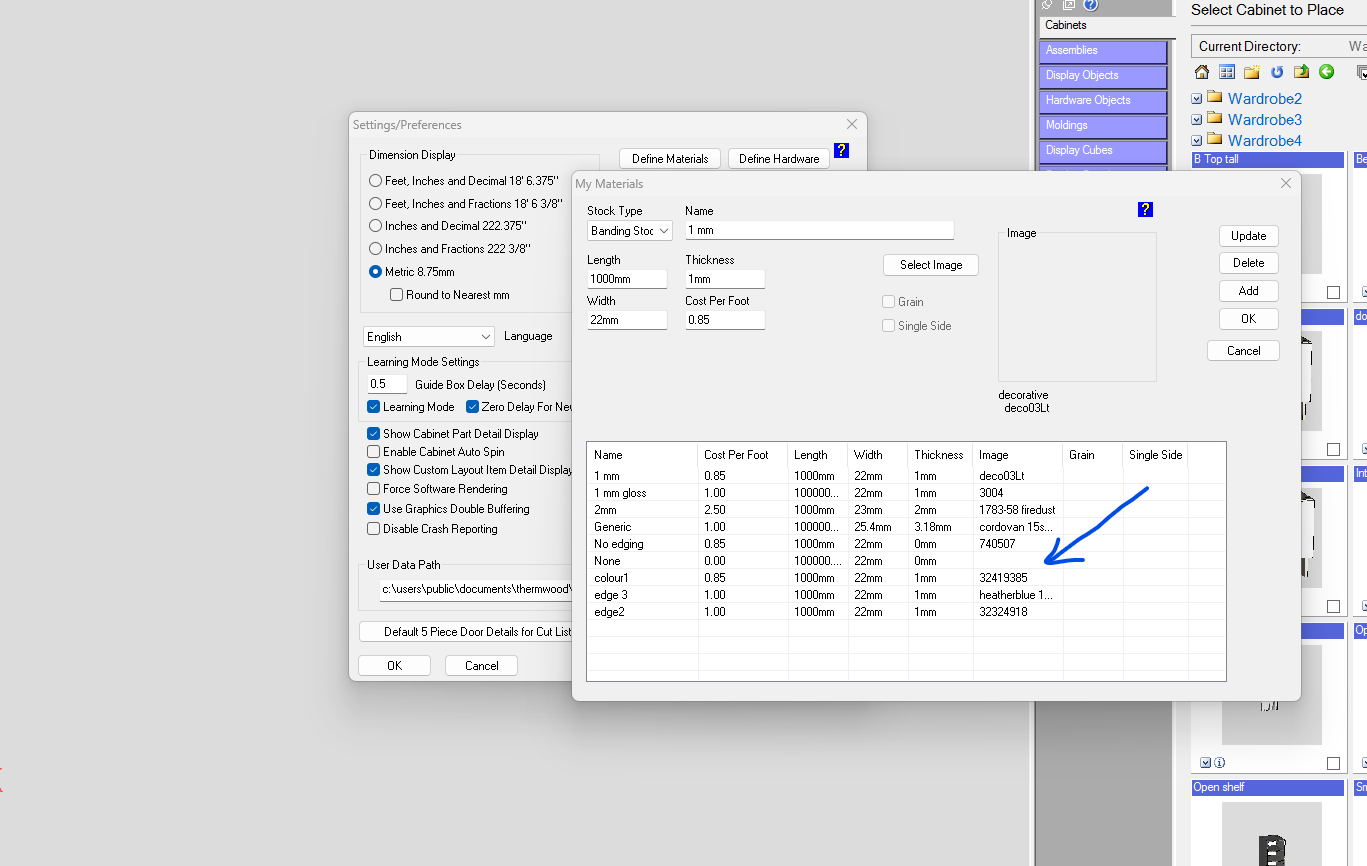

I had a random thought on this.
Check to see if all your edging materials have an image assigned to it.
I had named a material for edge tape called none with a zero thickness.
Somehow it lost it's image as in the picture.
(I reloaded it from another job that I knew had it on it to show you.)
I have now deleted that material from my edging list.
I have created another material called no edging to replace it.
Now when I load a previously designed cabinet with none edging, I replace it with no edging which has an image.
I haven't worked out if it was the problem or not. But worth a look at.
Also in the image below, There is the system None and the created None available as a edge banding selection.
I think the system None was added in after we had made cabinets using a material called None, but I cant fully recall if that was so.

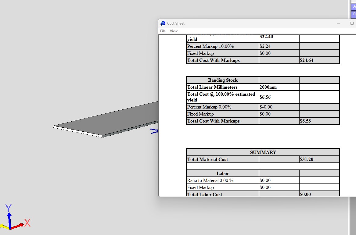

Clint if you notice the costings for edge tape is by the foot. In the 1st image, edgeband 3 is $1.00 / foot, but the length is by the meter as shown in the image below
Its just a little confusing if you are not aware if it.

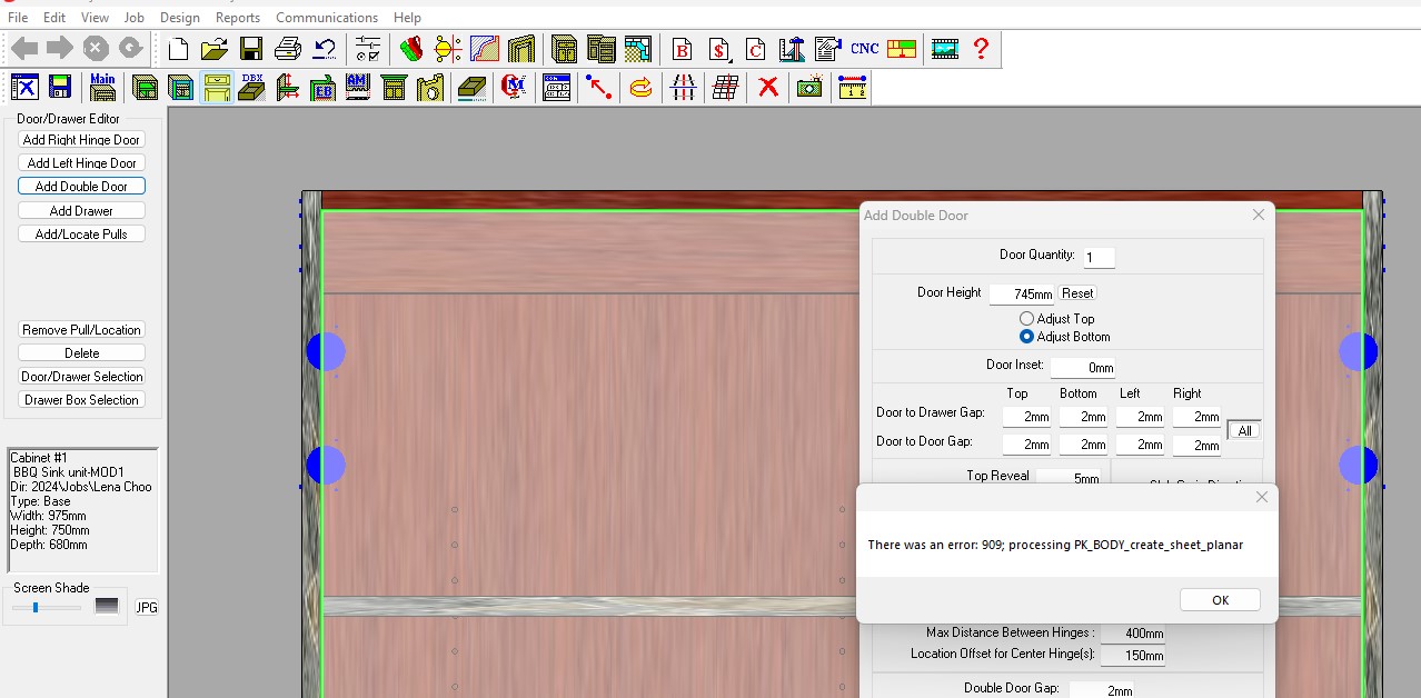

pressed D to enter drawer / door editor.
Selected door drawer selection to confirm correct selections
Receive error message. error creating outline segments (notice both the drawer and door have no edge banding)
I decided to recreate the drawer front, so select another old material that we have used before. (13 LARGER plain compact laminate 3660 x1830mm)
When I select the new material at about the 35 second mark, I select the reset view to reflect the new material change.
It come back with some error messages.
Notice that it now has edge banding selected, also the preview size reverts from the set size to the default size.
Also notice the field for drawer materiel is blank and the error message "material image not found".
(Its there, because that is the material that shows up in the new view)
I mess around for a bit trying stuff. and decide to just add the drawers anyway.
I put on 3 drawer fronts but the error message comes up 5 times.
The error message at 1.09 min refers to (not found in banding stock data base for a slab)
I decide to replace the drawers with doors.
Load the default door, error messages pop up and go through the same sequence of changing to a different material and at about the 2.10 mark again the banding materiel is now selected,
I change the material back to the original 13mm compact laminate and set default, figuring I will just see how it nests because it sometimes works.
Reload the default door selection at about the 2.45 mark and its now saying the edge banding material is not found.
The size for the edge banding that it is indicating is 3640mm by 1540 which is the size of the board selected for the door.
Reset the default door and it applies okay.
