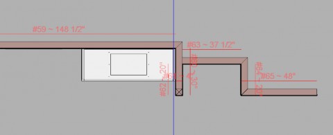

Any Idea how to fix the transparency on my text and dimensions in Custom Layout and the Line Drawing Editor?
This happened after a Windows update. I tried un-installing the update and updated NVidia drivers but haven't been able to correct the problem.
This is only affecting eCabinets, haven't noticed it any where else.

Un-installed the device and re-installed with older drivers and that seems to fix it.

Are you referring to the graphics driver you uninstalled and reinstalled an older version? Just want to be sure in the event other users come across the same issue.
Re: Faded Text and Dimensions
Yes, it was the graphic card driver. I had installed the latest from the NVidia website and it didn't help. The ability to "roll back" the driver from the Device Manager was greyed out so I got the latest drivers that Dell showed for my laptop, which were quite a bit older and installed them and that fixed my problem.
