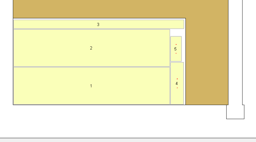

Can you add the border lines back to the parts when nested?
the new look is very hard to look at posting old and new as examples
new style
new style.PNG (5.02 KiB) Viewed 60137 times
old style
old style.PNG (6.94 KiB) Viewed 60137 times

Double check to make sure your Screen Properties haven't gotten messed up. View, and then Screen Properties. If you just use the default colors in Control Nesting, choose the Defaults button in the bottom left. If you use custom colors, set Outline Color to 200 for all three. Click OK, close Control Nesting, then open it back up. Renest and see if that gets it.

Same issue here - but changing the outline color doesn't do anything. :?:

To elaborate, all the other colors seem to work, and respond in real time. It looks like the outline just simply isn't there to be colored.

Control Nesting update just released that should correct the issue https://www.thermwood.com/updates_contr ... g_home.htm. This was the only fix for this version so we could get it out without having to do a whole bunch of testing and delay release.

Got it and it works, thanks Clint :beer:
