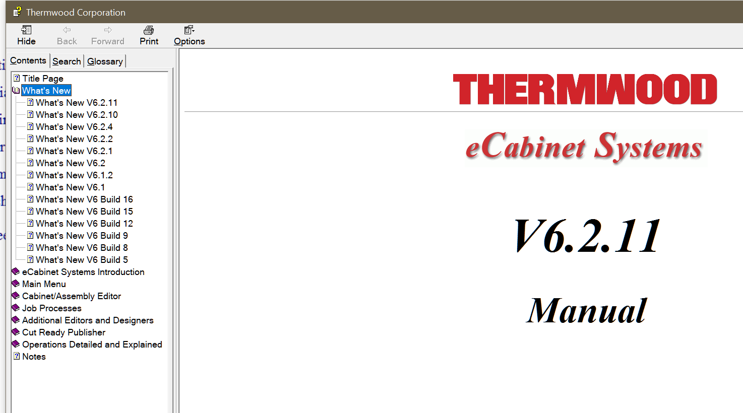

Interestingly, even though the new features seem to be present in the program, when I go to "What's New", there is nothing for build 12. I tried reinstalling using the Repair option, and that didn't change anything.

So strange. Even if you had gotten it from the prompt, they both come from the same place. Software engineer is making a change to the installer to always overwrite. I'll let you know when the newer installer is up. If you're desperate to see the help manual I can email you a link to download it, and where it goes on your computer. Let me know if you're desperate.

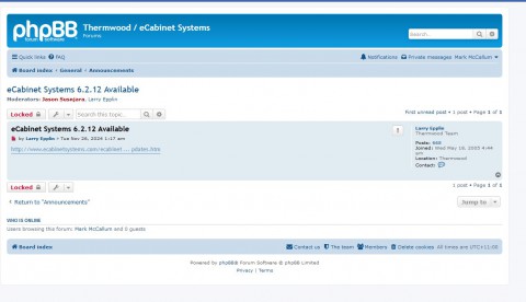

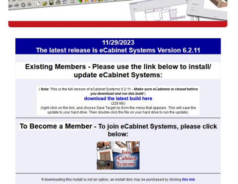

Re: g parameters Added ability to set nestinon individual parts (Added)
Hi Guys.
Thanks for the recent updates.
As to downloading, similar result to Jeremy
I downloaded from the popup within Ecabs. which installed the latest version.
To download a copy to put on a usb to update the factory computers, I clicked on updates through the link in the below screenshot.
And it still takes me to the old version and downloads the old version as in the screen shot.
The fixes additions change log on the update page is still showing the old version sept 2023.
Mark
Clint Buechlein
Posts: 787
Company Name: Thermwood Corp
Post by Clint Buechlein »
Mark,
Your page is likely cached. You can either choose the refresh icon in your web browser, press CTRL+F5 to force refresh, or clear the cache in your browser settings.
