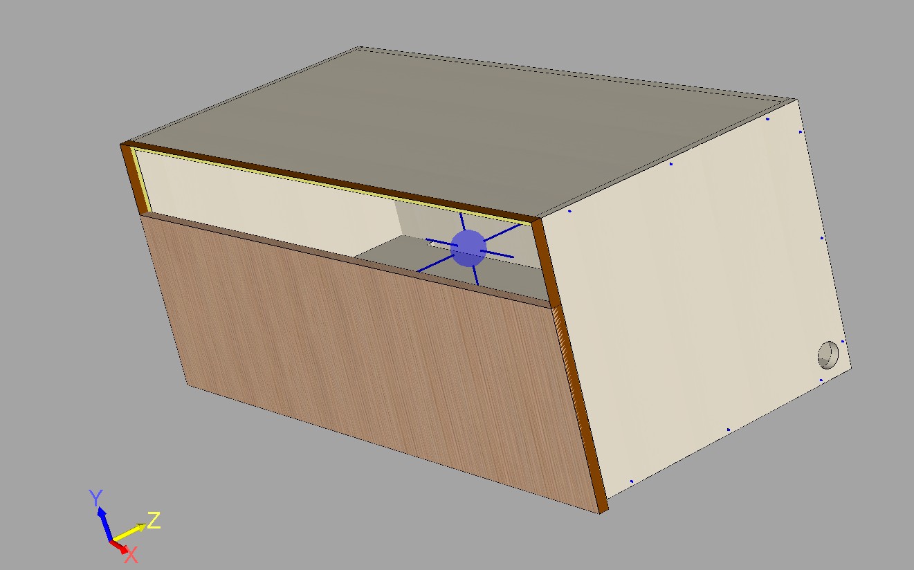

Unfortunately, many problems in eCabinets were not fixed with the latest updates. It’s frustrating when simply moving a hole causes the door to be shifted, which then has to be deleted and reinstalled. :wall: :wall: :wall:

Ingbert,
Which hole did you move? Can you post the cabinet so I can take a look at it?
Its likely something is broken on the cabinet, and moving the hole is what brought the issue to light?
May not be the case for your issue, but often I have a customer send in a cabinet saying when they move a shelf or do something else, XYZ happens to the cabinet. A lot of the times I can simply load the cabinet, click in the height, width, or depth box and press enter to force a regen of the cabinet and the same issue happens. Not changing dimensions of the cabinet, just forcing it to go through the process brings the issue out.

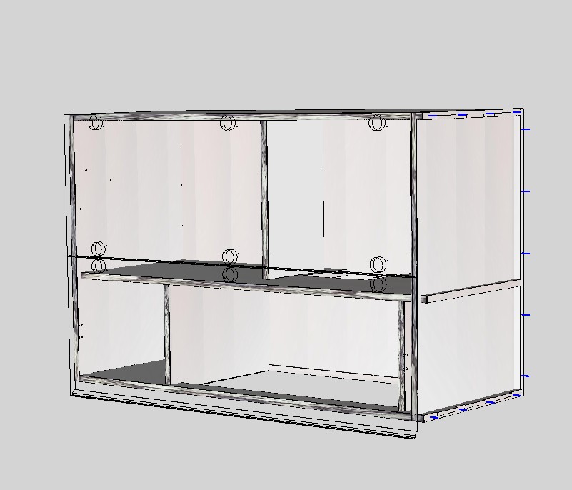

Its things like, Saving a door or drawer design and the next time you open it its message is material not found, or the body has gone, Or hole patterns just disappearing, generally off drawers in assemblies, and you don't notice until its cutting on the machine, or edge banding body not found, (that one doesn’t seem to affect nesting or cutting) or like today, yesterday I spent a couple of hours on placing holes and cutouts on a R/hood cabinet, I just need to put 3 stretchers and one more cutout, today I open it and the right hand end has gone haywire, Thursday / Friday it was an end panel not flip oping properly.

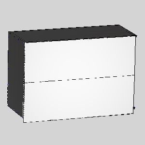

Range hood cupboard . Salice lift up doors. (drawers for doors)

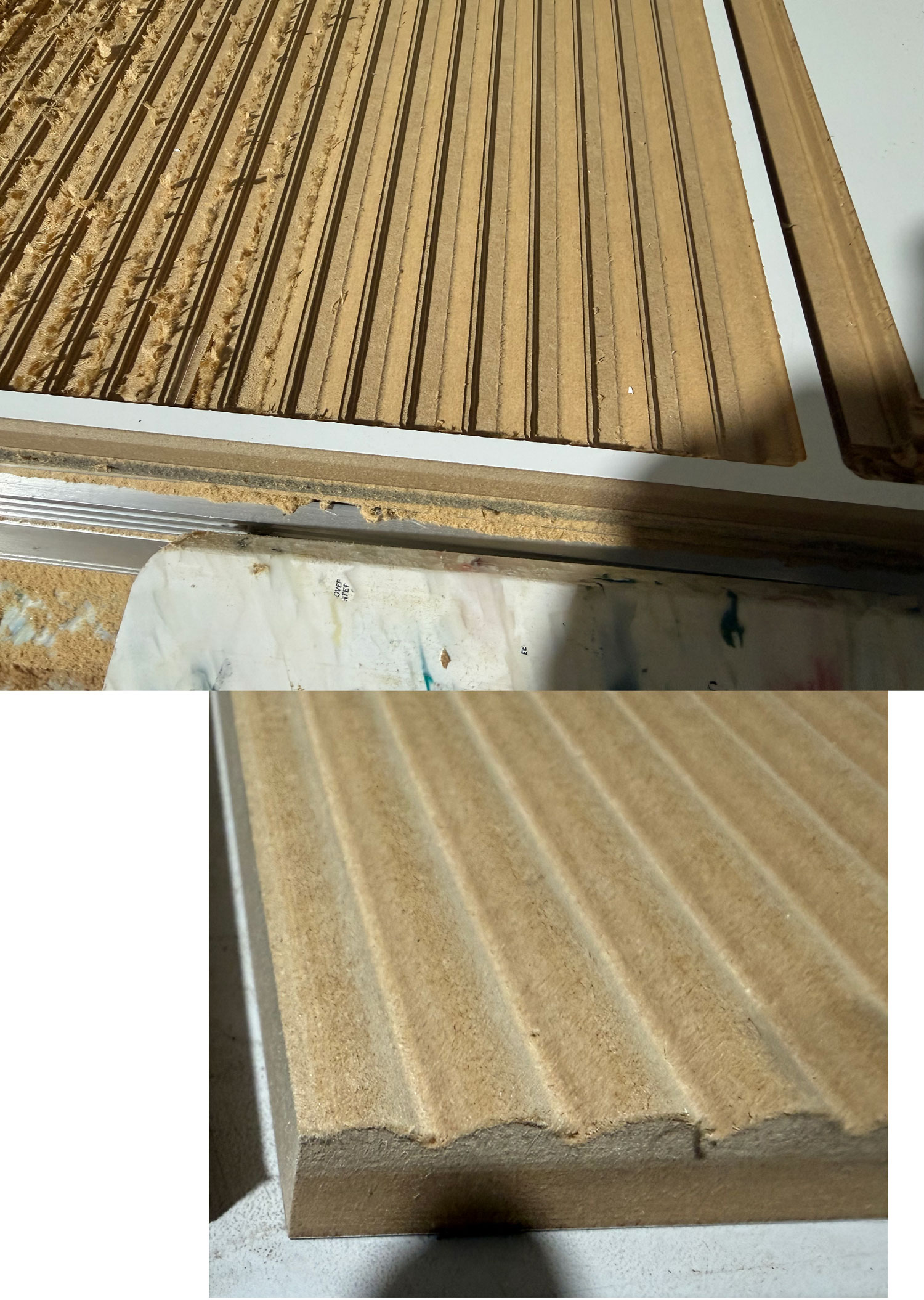

How its supposed to look and how it cut
I know if we identify the causes you will fix it, Its just that its not easy to find the nasties.
Anyway because I am here, I have attached the broken unit from today, no idea what or why, all I did was save it yesterday and reopen it today.
I didn't bother with saving the panel job nesting / tooling, (It was probably just specific to that piece, so not worth the time) . I just redid it without the front return and nested it by itself and it worked fine, except now I have to put the funny little return on by hand.
