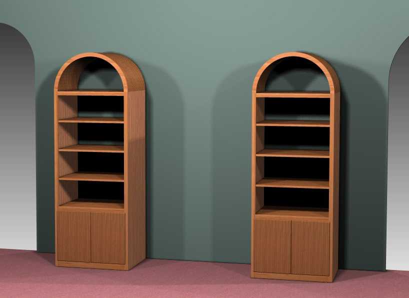

Not perfect of course, but I made it arched, or barrel vault. :D

Yes you did, and a nice job of it! Nice presentation too, nice lighting angles.

WOW. It's always amazing what can be done.

Build it! I just figured out how to DRAW the blame thing. Too low tech for fancy stuff, think will use bendy board, and then skin. (Any offers to make the arches?) :lol:

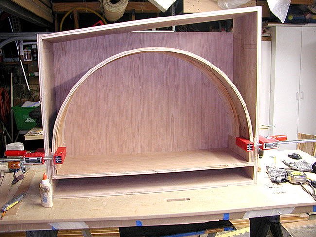

Jon, you can buy half circle 5/8\" in standard sizes but I have never been real happy with them. If you want to send me the info on what you need I will quote you or send you in the right direction. Also do curved molding to match.

Good work on the rendering. The design is elegant but I would be nervous about using flex-wood since there is little support for the arch, especially during moving to the site. I would use a rigid arch. Try these folks for rigid arches pre-molded in 5/8\" plywood.........
http://aitwood.com/StoreFront.Asp?WoodT ... 20degrees)
Excellent delivery service from stock. Make sure you specify that both inside and outside surfaces will be exposed and veneered. Cost with shipping should be around $100 + or -.
See attached pix of one being glued up into a top library cabinet for a sloped ceiling. Full rendering is shown under \"Cherry Library\" in this section.
