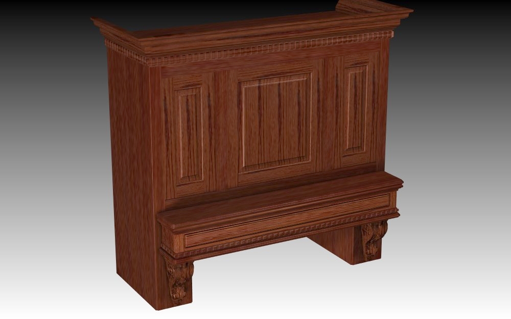

I am copying an idea for a hood from Jon Giordano's web site. I thought it was a nice design. I should have the eCabinet drawings done tomorrow and I will post them if you like the design. That link is to a Flash presentation so you will have to scroll through a couple of pictures to see the hood.

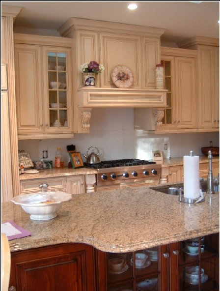

Here are a few I did. I would be glad to share the file if you would like.
Brian

Another that was too large to send last post.

Brian
The rhea hood looks good, the problem I'm having is getting it to integrate into the uppers on either side.
The transition from 12 5/8\" deep uppers to an 18 or 19\" hood depth.
Yeah send over the Rhea hood and maybe I can figure out how to integrate it or maybe modify it.

Here is Jon's picture. I am almost through with the eCab drawing I will post later if you are interested.

Very nice that is what i was trying to do i think, I like the way the lower vertical sides interact with the top cabinet and the shelf front.
Yeah do post it when your done.

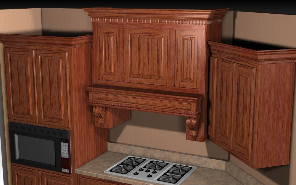

Brian,

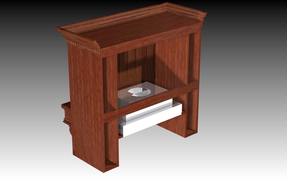

Here is the assembly for the vent hood. I didn't get all the details worked out but you can get the idea. You should be able to re-size everything. I made it fit a Dacor 30\" insert which I did a mock-up so I could see how it fits.
Here is a shot of the back side of the hood showing how the hood insert fits. My customer had originally wanted a Vent-a-Hood insert which was a really tight fit but changed to this Dacor.
That is the great thing about eCabinets, making sure everything fits before you start to build.
