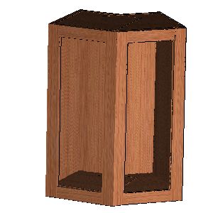

Like this Vince?
outside angle.esa
(284.65 KiB) Downloaded 914 times

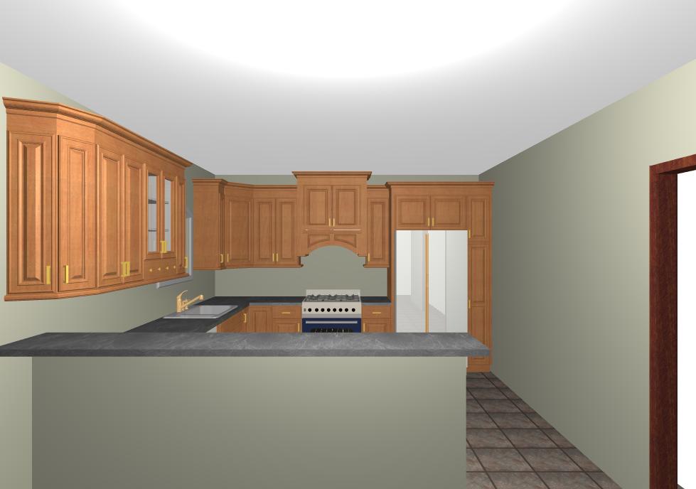

I will try to post a picture of the rendering that the deale sent me.
It is the cabinet all the way on the left that returns to the wall at an angle.
Vince

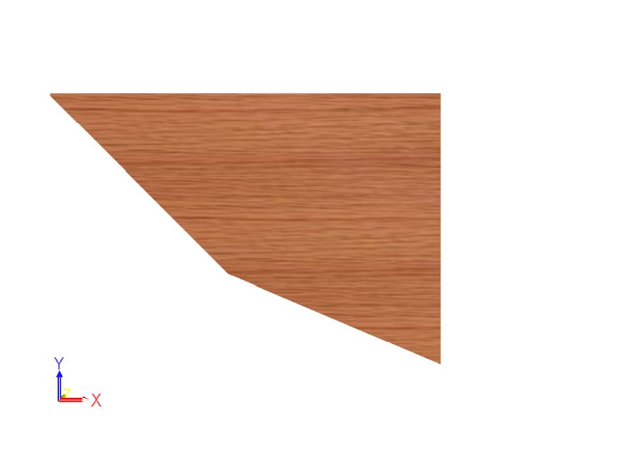

Here is a better representation of my question. Does the shape look something like this from the top?
Angled Return.jpg (25.1 KiB) Viewed 16271 times

Yes that is very close, the back and right end are equal dimensions of 12 1/2\", and the angle is 22 1/2 at the right end and left back. You appear to have it , just that the dimensions and angles are not quite right.

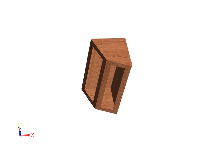

I tinkered around with this a little Vince, and this is what I came up with.
Vince.zip
(100 KiB) Downloaded 880 times

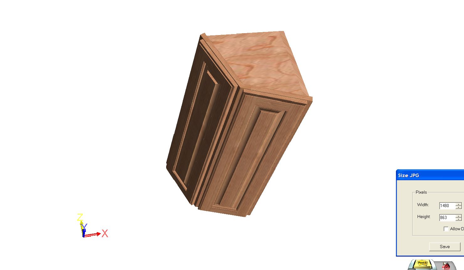

Angle Return Cab.jpg (71.08 KiB) Viewed 16203 times
Nice work Vince! Amazing software eh.
