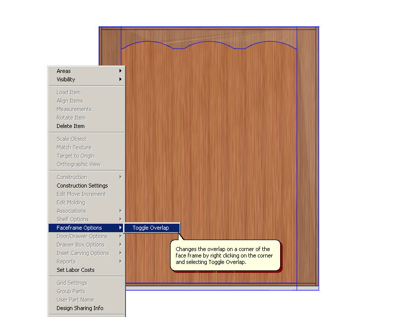

John
Why not just use Toggle Overlap? Right on a corner of the face frame (in the Face Frame Editor) and select Face Frame Options -> Toggle Overlap.
Do this for each corner that you want to change.
Toggle Overlap.jpg (71.91 KiB) Viewed 9610 times

by John Scaravella » Thu, Feb 22 2007, 5:33PM
toggle overlap worked great. Thanks, John
