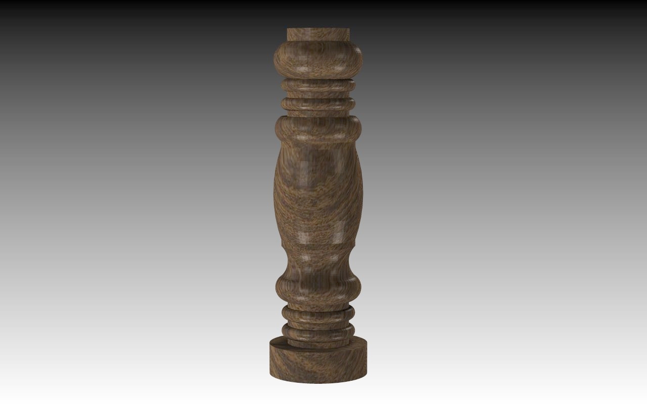

This is an Island I am working on and even though I select Gouraud when saving the legs in the Display Part Editor, when I render the view all of the facets show. Is there something I can do to correct this?

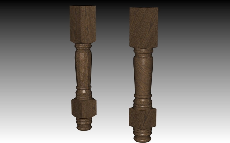

No Mike,
They are 5X5 legs from a vendor. I couldn't find 5X5 legs from Adams Wood Products.
Justin,
This must be a problem with the number of segments this company used to create their drawings as a turning created using eCabinets still shows facets but they are much smaller and not so distracting.

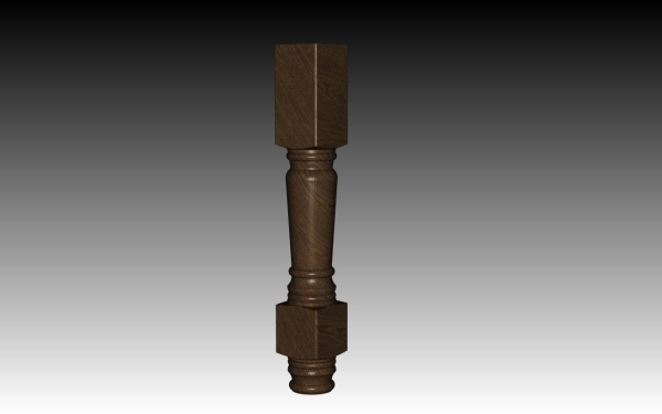

I was able to model a close facsimile using the Shape manager and the part editor. The eCabinet model on the right renders much better than the vendors model on the left.
