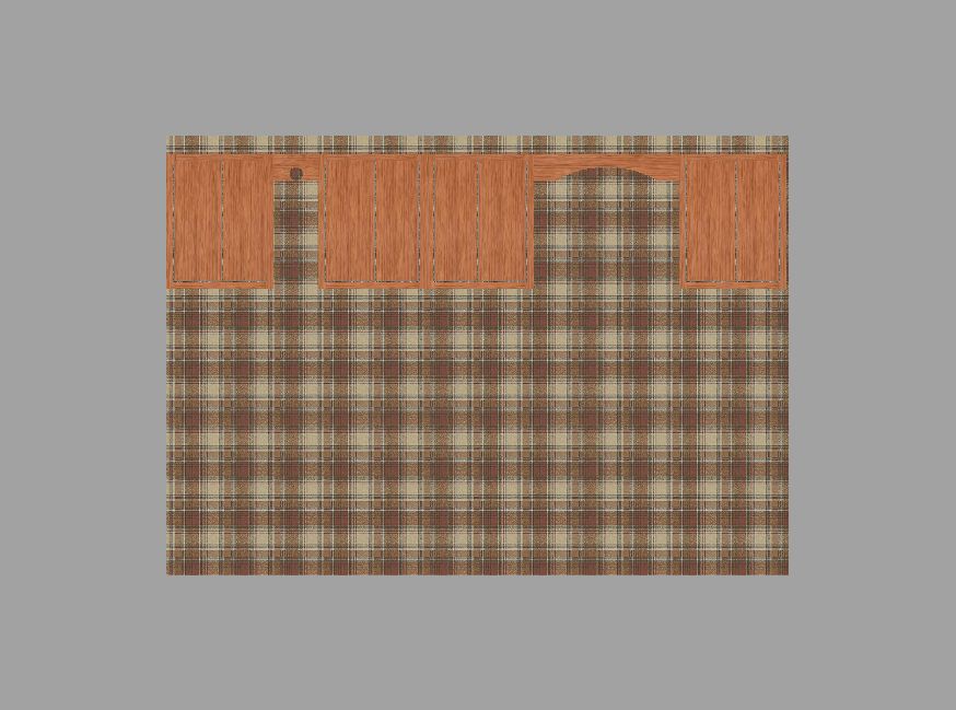

Why I made them out of a upper std cabinet the valance. Is from the back panel of the cabinet that way I could put them right in the custom room and set it in place.I bring the back 11 1/4\" in
The left is a straight valance and the right is a cut out valance.
The cut out valance locks to the wall but will not lock on to the cabinet
