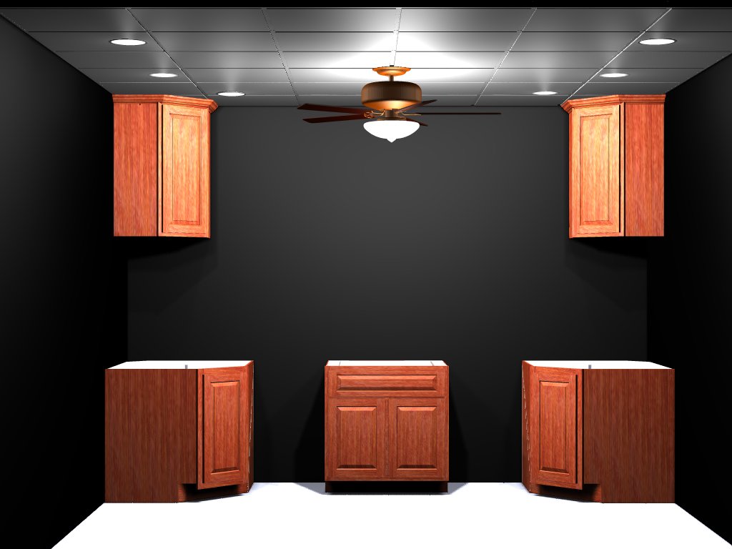

How would I make ceiling lighter
I need to make the drop ceiling brighter
Going to get a new graphics card and bring memory up to 2GB
tonight.

You have too much time on your hands George.
I can't help with this one.
How did you create the panels and rails?
I haven't tried it but...
A display panel with the shine cranked up and placed on the floor. Then before presentation mode associate the panel to a small wall and hide the wall and associates. Hopefully this will reflect the light upwards.

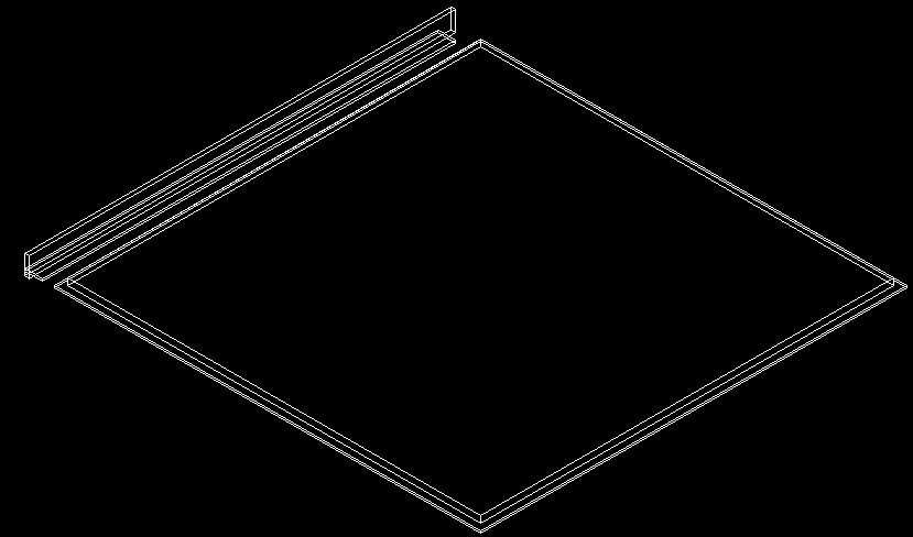

Hi Michael
I make them in my other program and use it in that program to show my
customer it in there new home that I design for the customers.
Tis ceiling is 12' x 12'
Tile 2'x 2' x1/2\"
Tracks 1\" x 1 1/4\" x 12',4',2' long
Symobol Generator.jpg (33.09 KiB) Viewed 4054 times
George,
Try your ceiling without the can lights and place a chandelier close to the floor to light the ceiling. The can lights focus light down and everything above them is calculated as shadow.
Give it a try.
That was it Thank You Kerry :beer:
