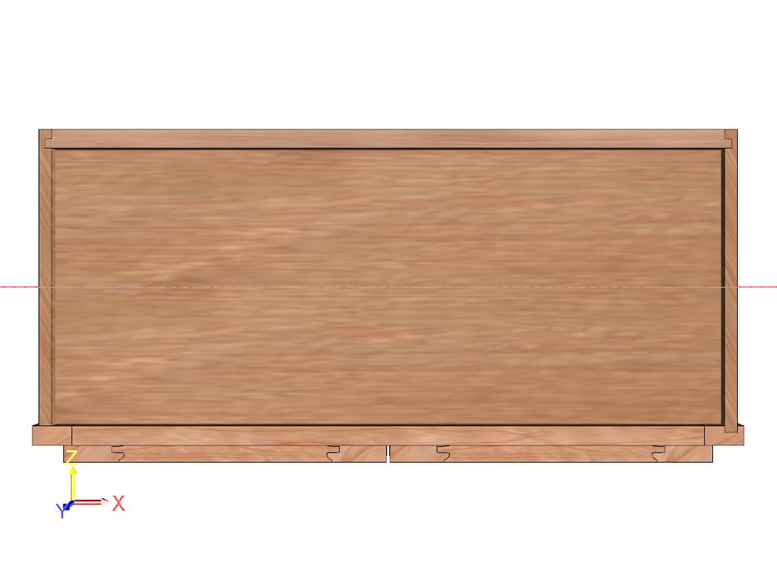

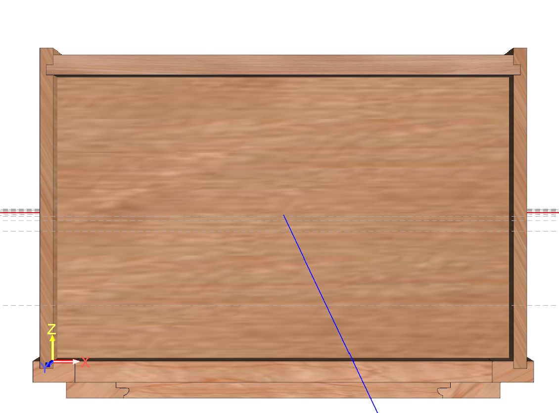

In my cabinet construction I use stretchers set to the back of the cabinet and dadoed into the sides of the cabinet as nailers. With the new version I've slowly been getting around to updating my seed cabinets. Anyway, I starting working on the changes I wanted to make and one of them was to use the face frame dados for the cabinet sides (previously we set a -.25 front inset) however whenever I try to set side dado's into the front face frame the back stretchers move in. I can not get them flush back out by using the stretcher adjustment...I've tried deleting them and adding them back in - same result
I've attached one of the offending cabinets...if you would please take a look at it and see if it's a bug or if I'm missing something...
Mark
this is what has been happening when I use the dado setting for the face frame.
stretchers pulled in.jpg (71.72 KiB) Viewed 4836 times
this is the correct placement of the stretcher with the negative front inset...
correct stretcher placement.jpg (60.13 KiB) Viewed 4836 times
W1830 L.hsf
(561.3 KiB) Downloaded 352 times

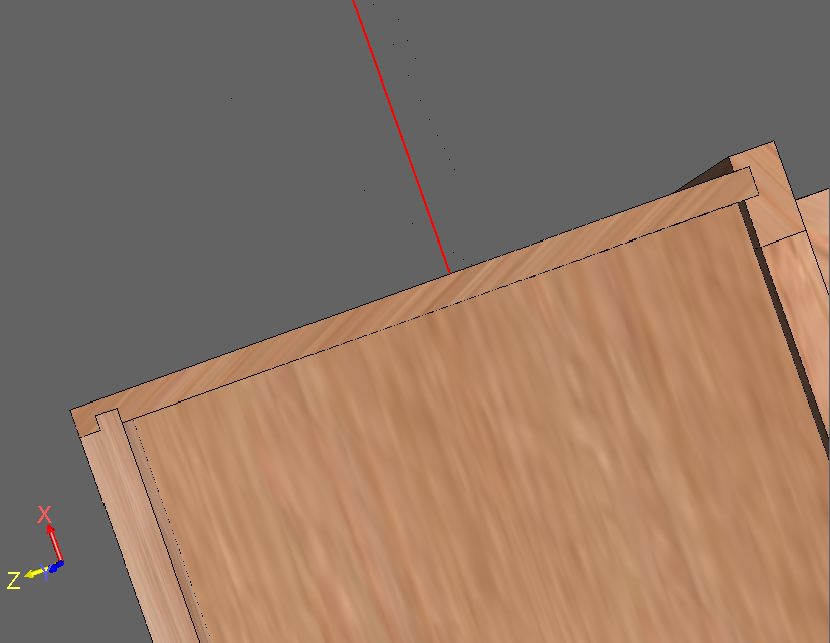

Hey Mark, I set inset #4 to 1/4\" and locked it. It seems to work ok now.
strecher issue.jpg (36.68 KiB) Viewed 4819 times

Rick, I've tried locking it at \"0\" but it still wants to move in...the stretcher looks flush with the back in yours, why would it be set at 1/4\" instead of zero?
Mark
I tried setting it at zero the first time and got the same results. (hence the 1/4\" inset). It probably has something to do with the dado configuration.
