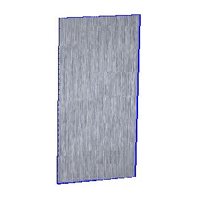

1 thing i want 2 point out is the the 3mm holes i was doing went right through the end.
On cabinets i still get the message come up saying Error creating route bodies.
I have posted a cab it happens on. And i cant even take an end to constanist manager ,

Thom,
Is this the cabinet you intended to attach? I do not see any part editor cuts on it. When you say "right through the end" do you mean the edge of the part or a hole going through on a right or left end of a cabinet. The cab attached here is only a cabinet back with edge banding around it. What do I need to do to reproduce your issue with this attached cabinet? Can you please give me more info on this because I unfortunately was not aware of your problem? The issue I had the programmers fix was not from you, that I know of, and it had to do with a hole interfering with a dado at the same depth as the dado. If you can help me reproduce this, I will ensure that it gets looked into.
