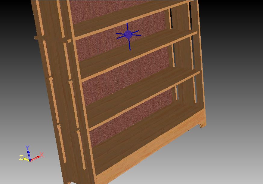

Can constraints for a part be copied to other similar parts? I have made cuts on a shelf and constrained them, now I want the same constraints on all the other shelves.

Paul Ellis wrote:Can constraints for a part be copied to other similar parts? I have made cuts on a shelf and constrained them, now I want the same constraints on all the other shelves.
Paul,
You cannot save the contraints as a file. The constraints are saved to the pieces that they are applied to. So, if you copy a cabinet that has constraints applied to it, the constraints will be copied as well.

Thank you Todd. I was afraid that would be the answer. Could this be put on the wish list? (anyone else interested in this feature?) Perhaps it could be saved together with the 'Load geometry'? And then have choice to change individual constraints once that part is created? Just a thought...use it dont use it :)
