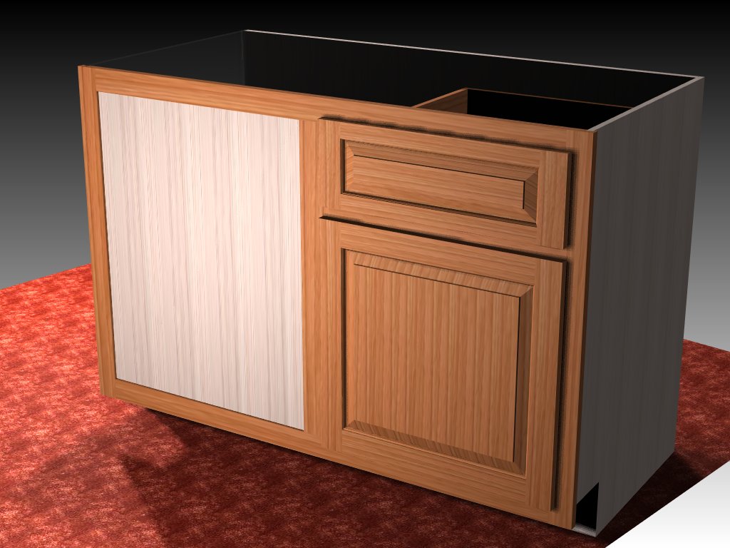

Hi guys.
How are you making your blind corner cabs in e-cabs? I did it before, but now when I try to resize my old cabinet or one from the \"standard\" library I get an error like \"the dimension will result in an unstable cabinet\".
Thank you,
Brent Brown
Michael Yeargain
Location: South East
Post by Michael Yeargain »
Brent,
For a blind Left or Right cabinet I use a 26 1/4\" left or right (respectively) stile of the sheet stock for a face frame. I inset the stile the same thickness of the cabinet material to account for the top and sides. This will allow you to place a door as well as stretch the cabinet without any problems.
The mouse curser is located on a 26 1/4\" left stile inset at the top and left side of this cabinet. I also had to inset the top, sides and deck the same thickness as the faceframe stock.
Hope this helps.
