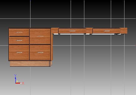

That's a good idea, but not exactly what I was looking for. I'm doing some commercial laminate casework, and I'm attempting to design a desk where it has small pencil like drawers underneath and you can sit underneath it with a chair (open underneath and attached to the wall at the back, cabinet approximately 4\" high.) I need to bridge between the doors with a faceframe like panel which will have to be banded on a few edges. Right now I've attached a display panel and will just have to remind myself to allow for edgebanding I guess. Sure would be a great feature to implement in the future I would think! I've attached a picture so you could see what I'm attempting to do.

Post by Nick M Singer »
Load a door panel in the material you want and that will have the edgebanding allowances you specify

Post by Jay Waters »
Thanks guys. Many times I (maybe we) get so wrapped up in finding a solution it eludes us because we're too close to it. That's a great suggestion Nick. Thanks for the help fellows.
