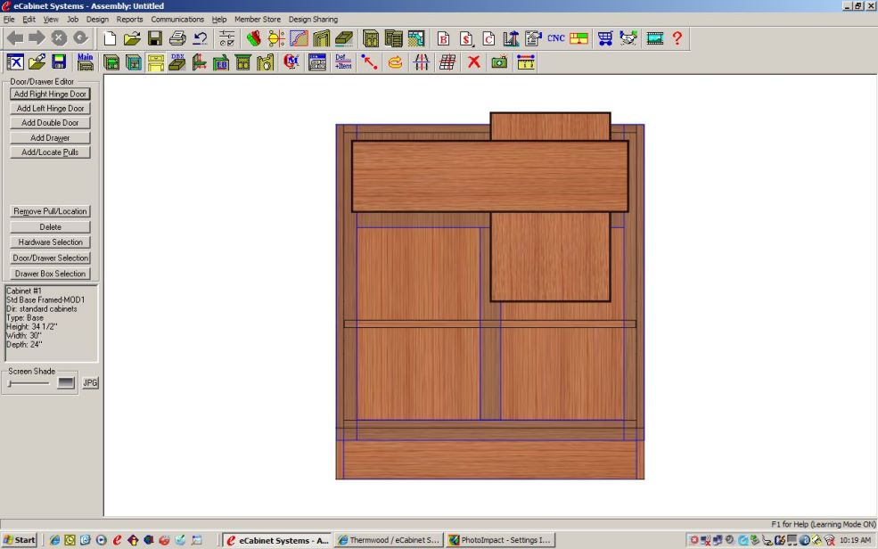

I was changing some settings in the Door/Drawer Editor while creating some images for an earlier post, and I ran into the problem I show in the image below.
How I got this result:
1. Started with a Standard Base Cabinet
2. Went into the Door/Drawer Editor
3. Selected both existing doors, to make changes to the Insets and Overlaps
4. Changed the Door Inset value first, and clicked OK - no problem
5. Changed the overlap values for the existing doors ===>> BAM!!! Doors reacted badly, as shown in the image below.
I can reproduce this, so it does seem to be a bug. This does NOT happen when removing the existing doors and adding new ones - it happens ONLY if I change the settings of the existing cabinet doors.

This has been an issue for some time. At least with all three of my computers. If I select the doors and front, make changes they do weird things, such as the image above. One of these days it will get fixed.

Luckily, the fix is easy enough: Simply delete the existing door(s), even after they acted up, and place new ones in the Door/Drawer Editor; THEN everything is OK with the doors.

Are you able to reproduce THIS problem with existing doors? Mike reported he still gets similar errors when working on existing doors. Maybe Mike and I are the only ones having this problem.

I have had the problem you're talking about but mine seems to manifest itself in a different way and it seems to be more random and not reproducible. When I resize a cabinet the doors don't always resize properly and stay the same size. Actually one door seems to do OK but the second one seems to not get sized right and moves off center. The program no longer sees this door and it cannot be selected. It is also part of the cabinet and will be move to any area with this defect. The only way I have found to remove it is start over, total failure in other words. I have not experienced this in build 4, but I haven't done a lot in build 4 as it is so new.
