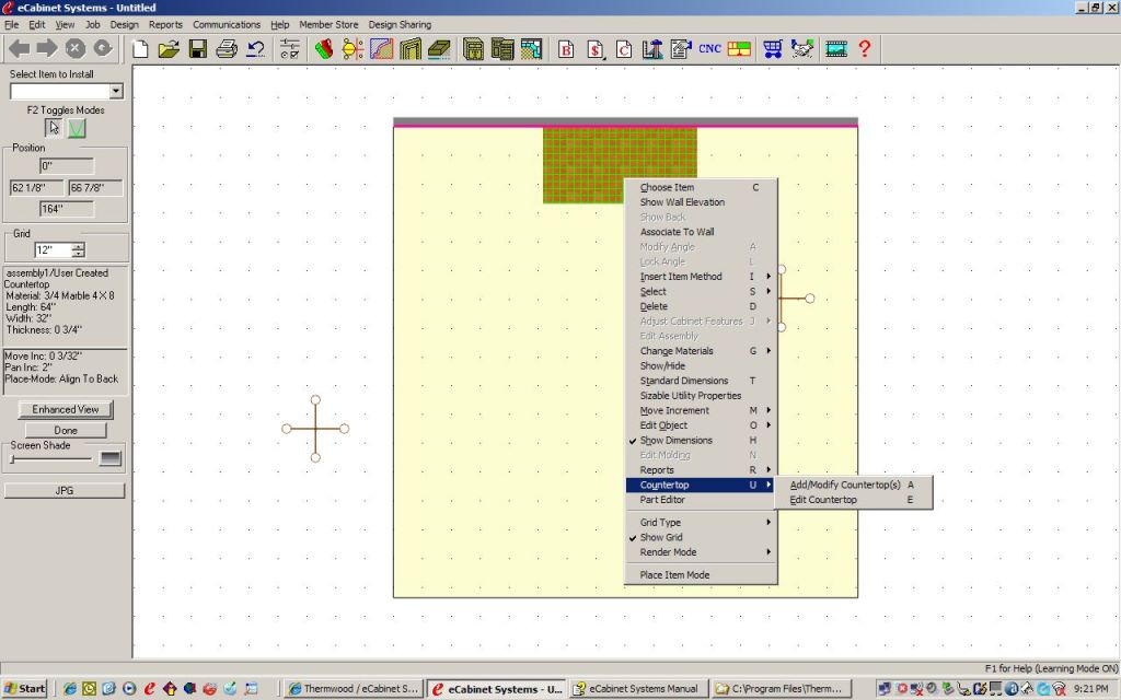

You can edit the countertop as follows:
1. In the Custom Layout/Detail Room, double-click on the countertop to highlight it
2. Right-click and select Countertop/Edit Countertop

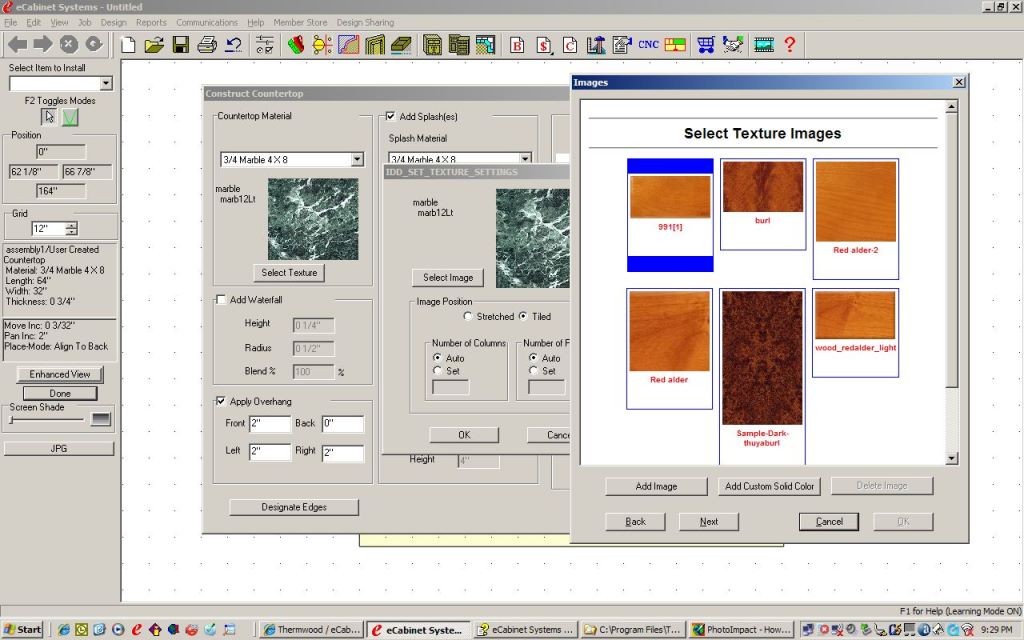

3. NOW you can select an image to apply

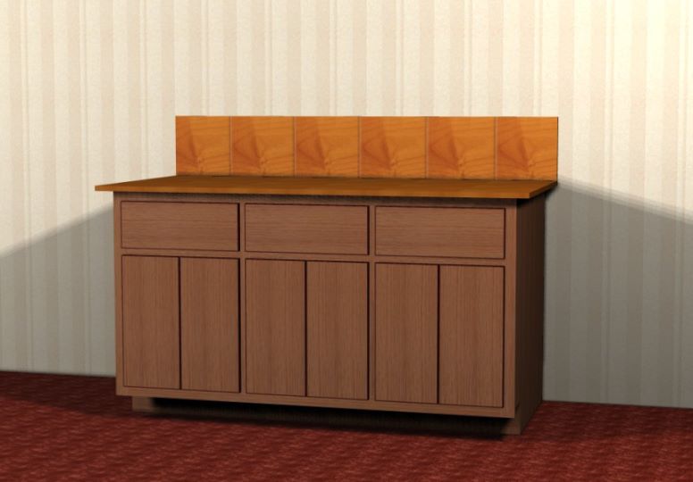

You can create a texture sub-directory within the materials folder of eCabinet Systems and add your own images, from which you select the the material image to apply. I provide an example using alder, for example. It be anything you can imagine.
How to change countertop image.jpg (95.26 KiB) Viewed 3368 times
How to edit countertop image.jpg (73.46 KiB) Viewed 3370 times
Some alder texture as countertop.jpg (40.92 KiB) Viewed 3376 times
